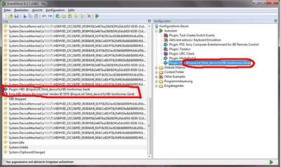

Heres a Screenshot about my EG Situation... I wonder about the Device Name "@input.inf,%hid_device%,HID....". Every other device in the list appears with a "normal" name.
Re: SoundGraph iMON HID plugin
In version 0.3 the problem of broken name is corrected. I'm only remove the consequence - now name of all iMON devices is "SoundGraph iMON HID".brand10 wrote:Heres a Screenshot about my EG Situation... I wonder about the Device Name "@input.inf,%hid_device%,HID....". Every other device in the list appears with a "normal" name.
The real cause is more depper and not in plugin.
