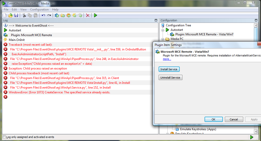

I followed your instructions with installing the new plugin but got a whole load of error messages from EG when I tried installing it from within EG.
Heres what I did:
I unzipped the file into EG\plugins
Ran "AlternateMceIrInstaller_x86.msi"
Rebooted
Opened EG, addedd MCE_Remote_Vista plugin
Clicked the install button
What did I do wrong?

The install button runs the correct msi (32 or 64 bit). The error messages just say that the service is already installed (since you ran the msi directly).
If you reboot (the installer changes the registry keys, but you need a restart with the keys in place to allow the plugin to attach to the IR receiver instead of the OS) and restart EG everything should start working.
