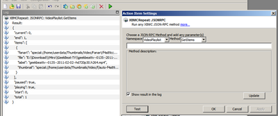

hanspettersson wrote:Can you post a printscreen or two please? :D
I'll try.
This shows the result in the log when I have a video playing in XBMC. The result is a Python object and the Items is a list of all media files in the current playlist.

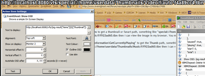

This ShowOSD action shows how to extract the thumbnail path and how to add the "http://localhost:8080/vfs/" part to make it a correct address. This needs to be a bit more complicated if there are more then one item in the playlist.

I get the path to picture whit "http://localhost/vfs/{eg.result["Thumb"]}"
But i cant show the picture whit that in the html...can i safe the result of "http://localhost/vfs/{eg.result["Thumb"]}" in a ex. "eg.globals.musicpic"?
eg.globals.musicpic = http://localhost/vfs/{eg.result["Thumb"]} is not working.
If using Python code you can use the eg.result variable directly. the below code should work.
eg.globals.musicpic = 'http://localhost/vfs/'+eg.result["Thumb"]

Post by hanspettersson »
Working perfect :)
Thank you very much :)

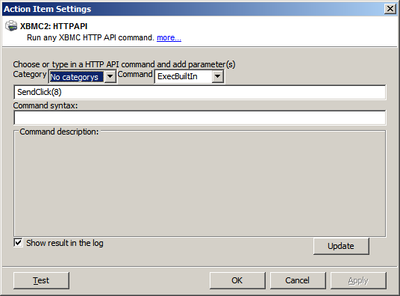

Is there a command in the new EG plugin for XBMC that will skip straight to the search library window? If not, I would REALLY appreciate if there were.
I haven't found a direct command for it, but you can use the HTTPAPI action in the XBMC2\Experimental folder, then use the ExecBuiltIn() command with SendClick(8) as parameter (see image below how it should look).
Looks like I need to update the plugin to retrieve the correct command information, fortunately the command still works without the information.
