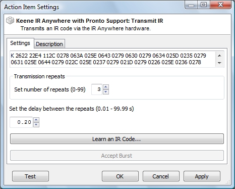

- Added support for sending pronto codes
- Added support for repeats & delays in between
- Added support for learning IR codes

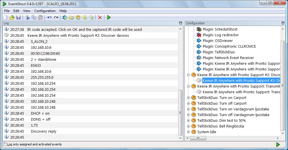

- Added support to discover your Keene IR Anywhere devices

How to learn IR codes...
Discover your Keene IR Anywhere devices....
