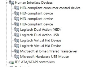

Devive Manager recognise this device as:
HID-compliant consumer control device
HID-compliant device
Microsoft eHome Infrared Transciever
I really don't know how to proceed from here. I need help on how to go on from here. Somebody please help. Thank you.

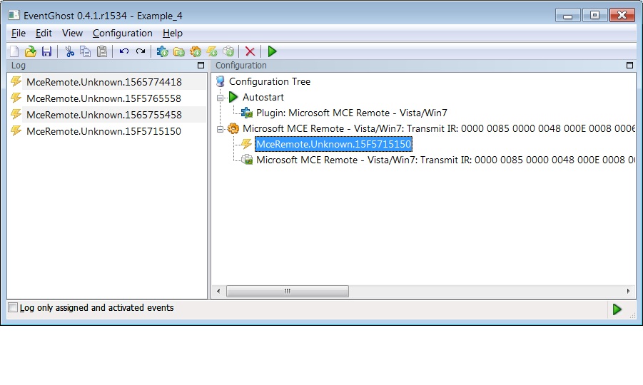

When I pressed number 1 on remote, there are four MceRemote events appered on the left. Then went on to click add event on the macro, one of the event appeared automatically below the macro. With just a single macro, I wanted to test but there are no IR fired at STB, even I drag & drop the remaining events. Please tell me if I left out something :?: . Thanks
giantpopples
Posts: 13
Joined: Fri Mar 26, 2010 7:34 pm
Re: Microsoft eHome Infrared Transciever
Post by giantpopples »
Seems good to me..
You can try with another remote to send the event - one that will only send 1 IR code - or check that the IR emitter is well connected on the back of the tranceiver (port 1 or 2, does not matter), and also check the positioning of the IR eye on the STB. For the last 2 checks, you don't need to use the remote, just click the action and click on the green triangle in the menu to launch it.

to test your transmit macro, right click and select "execute item".
if you have an MCE remote you should not be seeing 4 events like Mceremote.Unknown.*****
it should look something like MCEremote.Pause

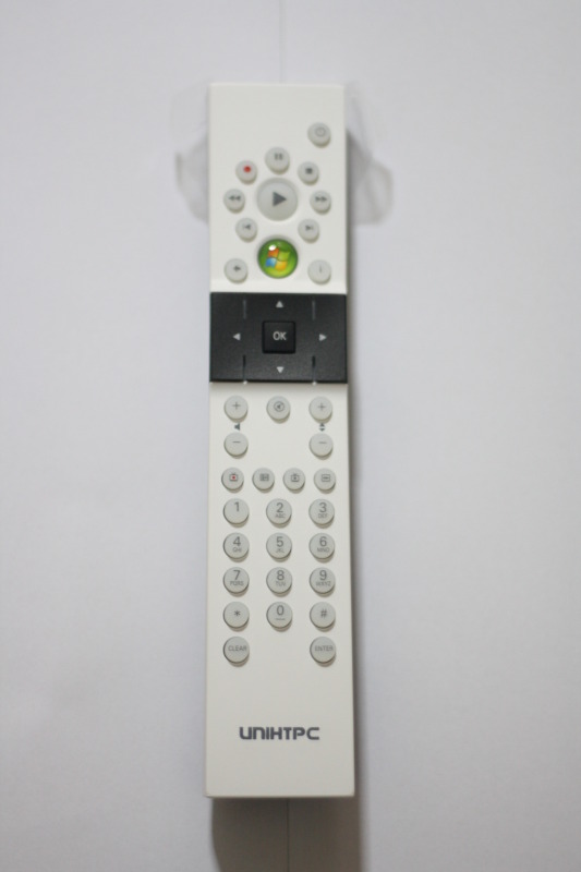

The mce remote code is captured as what you have stated, that is if number 1 button is pressed, it it showing as MCEremote.Num1. This is not the problem for me. What I want is to use my set top box remote to work with eHome IR Tranciever. Is that possible?
The mce remote shown in the above picture working as plug n play, that is without Eventghost. The problem is only the number buttons and volume are working. Play, pause, etc is not working as plug n play. What I want to do is
