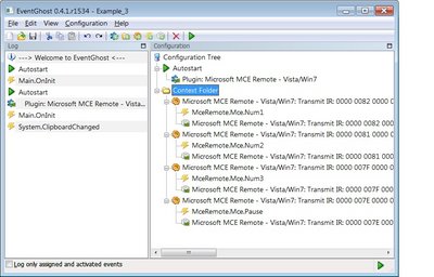

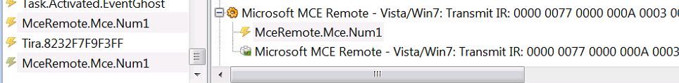

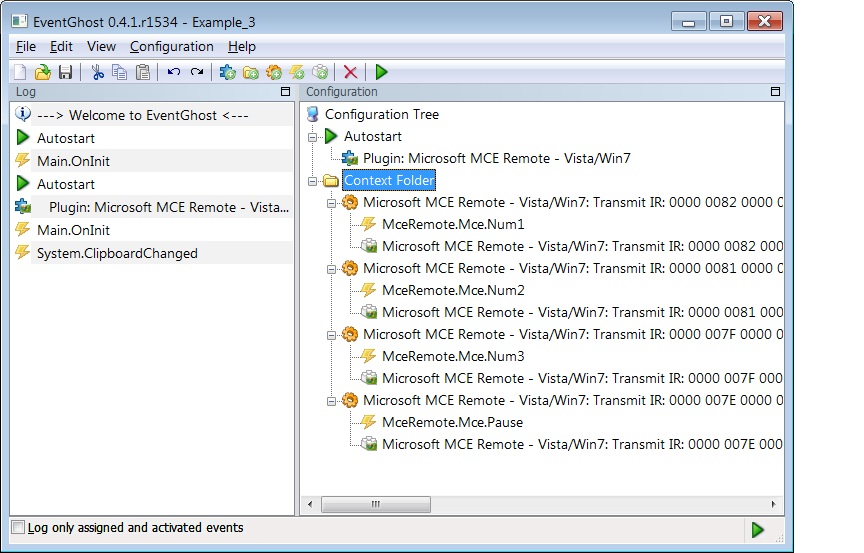

It's fairly straightforward to do this, just takes time to learn all of the commands. To make sure the IR blaster part of the configuration is working correctly, learn one of the device (STB) remote buttons first. Create a macro with the MCE plug-in and learn one of your remote's IR commands. Then execute that command with the emitter connected to your STB and see if it works. If it does, you're in business. Now point the remote that you want to use to control the STB at the MCE receiver and press the button that you want to use to trigger the command it just learned. This remote doesn't even need to be the same. It can be almost any IR remote. In the Log pane of EG, you'll see something like "MceRemote.Mce.Num1" (if you use an MCE remote control) or "MceRemote.Unknown.1234ABCD" if you use any random remote. Drag this Event to the top of the macro of the learned IR command. Now, whenever EG receives that IR command you just captured, it will blast the STB IR command you learned. It should look something like this:

Tried your method it only worked in the follwoing way:
Captured a few codes on the left, e.g, MceRemote.Mce.Pause using mce remote
Created a macro and learned IR code using STB remote
Dragged the MceRemote.Mce.Pause on top of the learned code
Executed with green button, it works.
But, using the STB remote aiming at mce reciever it don't work, any other IR remote also don't work.
Using mce remote aiming at mce reciever works.
However, my aim is to get STB remote (or other remotes)to work on the reciever.
I have crossed the biggest hurdle, please tell me if I have left out something on the EG.

The macro isn't triggering with your STB remote because you've only setup events from your MCE remote. I can tell from your earlier post that the MCE receiver is seeing your STB remote keypresses.
Just as you've done there, point your STB remote at the MCE receiver and press the desired button. You'll see an "MceRemote.Unknown.#####" event in the left-hand log pane. Drag that entry to the top of the macro that has the STB IR code Action you want to execute. When the EG macro sees your STB remote keypress (Event), it will cause the macro to execute and the MCE IR blaster Action will execute. You've had all of the individual parts work, you just need to put them together. What you might not be understanding is that you need to "learn" your STB remote buttons twice (Event and Action) - (1) actually learn them for the IR blaster Action and (2) setting up the "trigger" (Event) from the log pane.
