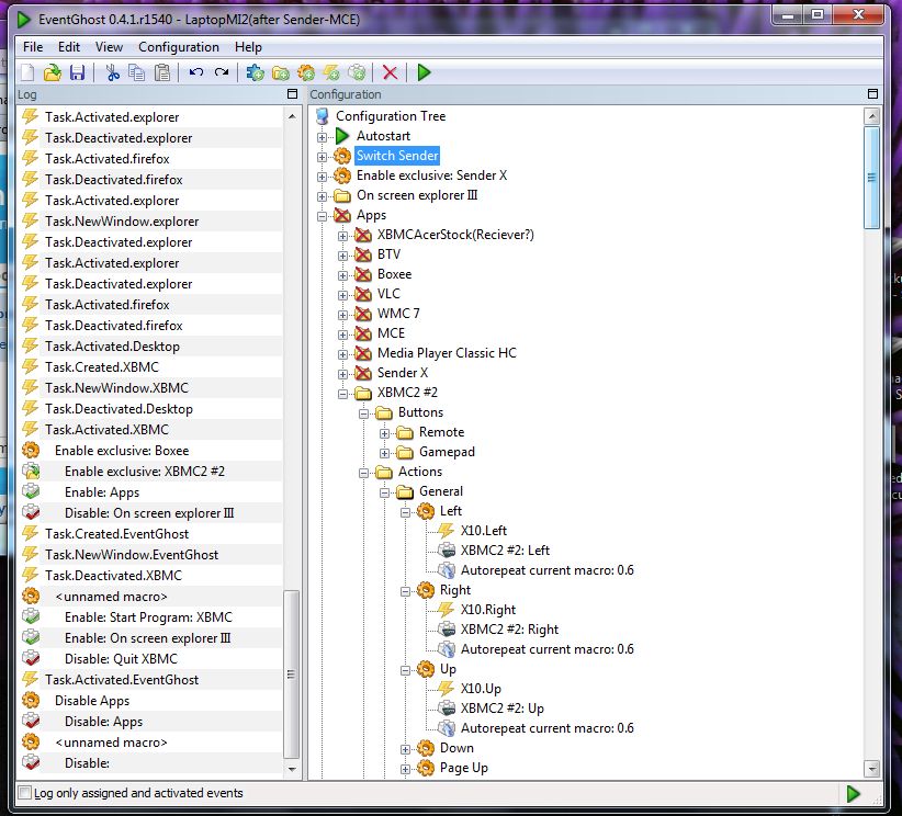

Get used to saving, starting new, backing up in EG. Nothing sucks as bad as tweaking a good EG XML file and making it bad. It's nice to have an old/good one to fall back on.
You'll need separate folders on the right side to stop the double presses.
I have (main) folders like this...
Apps folder (xbmc, WMC, foobar, iTunes etc)
Start/close Apps folder...
Task Switching folder...
And folder after folder after folder after that.
Baby steps.
When xbmc is active/open/in front on the PC...
Macros in the Task Switching folder makes xbmc (in the apps folder) EXCLUSIVE (won't send presses to any
Other apps running)
A macro will also make the "close xbmc" work/usable.
If I close xbmc properly a macro in the start/close apps folder will ENABLE the open/start xbmc macro AND disable the close xbmc macro (one button... Two actions... Open AND close xbmc)
Big step... Save for later.
Load the XML I uploaded....
Download it... Stick it in EG program files folder.
Start EG and open that XML I upped.
It might work... Might not. Will need some tweaking for sure.
Move xbmc folder (right side of EG) nto an "Apps" (or programs) folder you create.
Xbmc plugin is tricky to get right/perfect. I havnt yet.
So many darn options.
Those double presses come from other actions/macros/folders that are enabled... I think.
You want only xbmc able. Exclusive.
My XML might help to get started.
Make that program/apps folder and stick xbmc in it.
Start/stop program folder
Next lesson.
Baby steps.
Other apps running)
Next lesson.

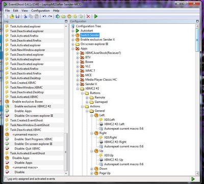

This is a partial view of my EG Config tree.
Just to show you my app folder.
(ignore this for now)
See the red X over the Apps Folder?
That will make none of the stuff in that folder work.
I have mine set that way for whenever EG.exe window is open, on top and viewable.... It disables Apps.
When any application in that folder takes over/is open/active on my PC that folder will be enabled.
(done with Task Switching-folder "Enable" Macros)
Lesson 5?
Lesson 5?
