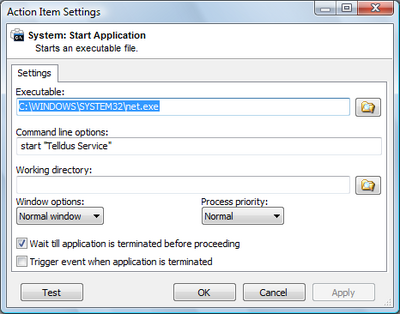

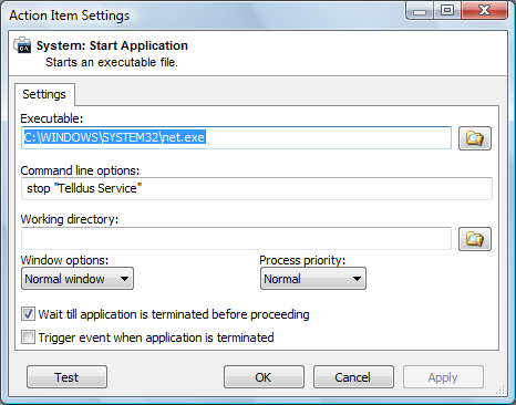

It seams I was little to quick, the Telldus center doesn't work if you resume system from hybernation. I order to get it work (also in EG) system must be restarted.
Re: Plugin: TellStick Duo
This is a problem of Telldus Center itself I assume.
A work-around you could try is what I have illustrated below. I am not sure if the event "System.Resume" or "System.ResumeAutomatic" works best for you (disable the one that doesn't work the way you want).
You can create a macro like this:
