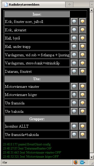

I made a small web-GUI using the default webserver-plugin, that I thought someone might find useful. It's very simple, but the selling point is that the webpage is generated by reading EGs own settings-file, so there is no need to keep the web-part and EG "in synch" in any way. Events with names ending in "on" or "off" are shown as icons, otherwise as the respective strings used in EG.
I'm very new to this so this might already be done by someone somewhere, if so, I apologize.
Any-who, my code snippet goes from 'EG.jpg' below to 'brytarweb.jpg' with nothing configured at all in the attached zipped index.html. I use it to control Nexa, Waveman and other RF-breakers with a Telldus Tellstick, some with the Tellstick plugin, others by calling a command-line utility. This is a first version with some swedish variable names and such, but as an example to build from I hope it may still be of value.
Use in any way you fancy. To try it out: Icons from http://www.famfamfam.com/lab/icons/silk/.
All in all this just maps an EG configuration tree, if configured in a way that the parser understands ("breakers" - "somebreaker X" - macros X1, X2, ..), to a simple webpage. It is not limited to the Tellstick plugin.

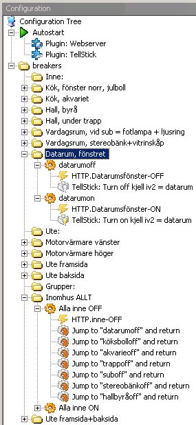

The code is very hard coded to what the EG settings tree looks like for me, just putting this out there for inspiration, not as a v1.0 production-ready something, so we're clear on that ;)
What it assumes is a settings tree which has a subtree like this (shown in screenshot too in first post):
folder 'breakers' (expected to be called exactly that)
  folder 'breakerX' (any suitable name for the device)
    macro 'operation X1' (any suitable name for the operation)
      event 'HTTP.something' (has to start with 'HTTP.')
      action that performs the operation (anything)
    macro 'operation X2' (any suitable name for the operation)
  folder 'breakerY' (any suitable name for the device)
    macro 'operation Y1' (any suitable name for the operation)
    macro 'operation Y2' (any suitable name for the operation)
It then generates a webpage that will send the HTTP.something events found in the settings tree. Only if all criteria mentioned above are met will it work, so, your settings tree is lacking at least one of the mandatory parts ('breakers' folder, having one or more device folders, each having on or more macros, each one with one or more HTTP.something triggers).

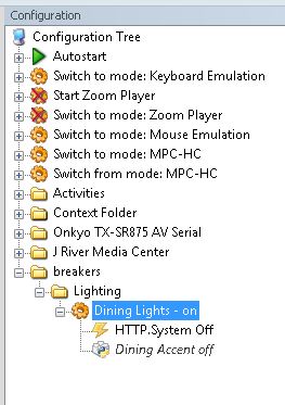

Hmm where's the 'lighting'-folder from the screenshot? Seems one level is missing from both the attached full XML and the pasted parts, that could be it?
Livin
Posts: 792
Re: EG with webserver-plugin, AJAX w/jQuery, simple example GUI
Post by Livin »
daniel.n wrote:Hmm where's the 'lighting'-folder from the screenshot? Seems one level is missing from both the attached full XML and the pasted parts, that could be it?
DOH - I had copied an old version of the XML. Working now :)

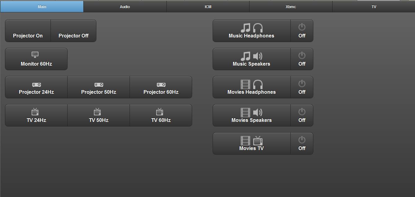

I made a simple remote page for controlling the video & audio and present it here so it's easier/faster for people to create for instance buttons with custom icons.
The foundations for the code came from viewtopic.php?f=2&t=2892
Then I updated jQuery Mobile to version 1.0. You have to understand I don't have prior knowledge about how AJAX&jQuery works and still don't know much. This is just copy&paste code from the vaults of the internet. That why there's also still some code in pages that are not really needed. I don't plan to learn everything about these things, I only need remote pages that work smooth. I will be using Android tablet as remote.
The top navigation bar is a simple ripoff of the original code. Because the active button did not stay active, I had to update jQuery Mobile to version 1.0. Now it works. I don't actually use the other pages right now, so I present only the main page.
The video section simply calls a batch file in EG that changes display settings. I don't plan to make it show which is the active configuration.
The audio section is because I'm using convolvers for equalizers and the buttons start the Vst-convolver programs. I can have multiple convolvers on at the same time, so there's two buttons for each convolver, one that switches individual convolver on/off and one the stops all other convolvers and starts the selected. For this section I'd like to have status information updated. I have already python script for updating the global variables and it works when I manually refresh the page but pressing the button does not refresh the page. So, how do I refresh the page when a button is pressed? I have found some code for only doing the refresh but I need the button that sends an EG event AND refreshes the page after that. ( There's seems to be some code in config.js from the original example that handles the button events )
Another question is how I make the transient background work for the whole screen? In Honeycomb's stock browser the black background is only seen for the page part where there's text, after that it's white background. In PC's Firefox browser it works as intended. Is this simply a bug in Android's browser?
Used icons were from glyphish and a mono icon set from some free icons site. Used Paint.NET to simply invert the colors or change it to red like the on/off-icon. Paint.NET preservers the alpha channel.

                	</div>
                	<div data-role="controlgroup" data-type="horizontal" >
                    		<div title="CCC_Profiles.Projector.24Hz" data-role="button" id="projector" data-icon="custom" data-iconpos="top" style="width: 200px;" >Projector 24Hz</div>
                    		<div title="CCC_Profiles.Projector.50Hz" data-role="button" id="projector" data-icon="custom" data-iconpos="top" style="width: 200px;" >Projector 50Hz</div>
                    		<div title="CCC_Profiles.Projector.60Hz" data-role="button" id="projector" data-icon="custom" data-iconpos="top" style="width: 200px;" >Projector 60Hz</div>
                	</div>
                	<div data-role="controlgroup" data-type="horizontal">
                    		<div title="CCC_Profiles.TV.24Hz" data-role="button" id="tv" data-icon="custom" data-iconpos="top" style="width: 200px;" >TV 24Hz</div>
                    		<div title="CCC_Profiles.TV.50Hz" data-role="button" id="tv" data-icon="custom" data-iconpos="top" style="width: 200px;" >TV 50Hz</div>
                    		<div title="CCC_Profiles.TV.60Hz" data-role="button" id="tv" data-icon="custom" data-iconpos="top" style="width: 200px;" >TV 60Hz</div>
                	</div>
            	</div>
        </div>
	<div class="ui-block-b">
    		<div data-role="content"  class="nav-big-two-icons">
            			<div title="VstHost.MusicHeadphonesOnly" data-role="button" id="music_headphones" data-icon="custom" data-iconpos="top" style="width: 250px;" >Music Headphones</div>
            			<div title="VstHost.MusicHeadphones"	data-role="button" id="{{"on" if eg.globals.Music_Headphones else "off"}}" data-icon="custom" data-iconpos="top">{{"On" if eg.globals.Music_Headphones else "Off"}}</div>
        		</div>
            			<div title="VstHost.MusicSpeakersOnly"	data-role="button" id="music_speakers" data-icon="custom" data-iconpos="top" style="width: 250px;" >Music Speakers</div>
            			<div title="VstHost.MusicSpeakers"	data-role="button" id="{{"on" if eg.globals.Music            else "off"}}" data-icon="custom" data-iconpos="top">{{"On" if eg.globals.Music else "Off"}}</div>
        		</div>
            			<div title="VstHost.MoviesHeadphonesOnly" data-role="button" id="movies_headphones" data-icon="custom" data-iconpos="top" style="width: 250px;" >Movies Headphones</div>
            			<div title="VstHost.MoviesHeadphones"	data-role="button" id="{{"on" if eg.globals.Movies_Headphones else "off"}}" data-icon="custom" data-iconpos="top">{{"On" if eg.globals.Movies_Headphones else "Off"}}</div>
        		</div>
            			<div title="VstHost.MoviesSpeakersOnly" data-role="button" id="movies_speakers" data-icon="custom" data-iconpos="top" style="width: 250px;" >Movies Speakers</div>
        			<div title="VstHost.MoviesSpeakers" 	data-role="button" id="{{"on" if eg.globals.Movies else "off"}}" data-icon="custom" data-iconpos="top">{{"On" if eg.globals.Movies else "Off"}}</div>
        		</div>
            			<div title="VstHost.MoviesTVOnly" 	data-role="button" id="movies_tv" data-icon="custom" data-iconpos="top" style="width: 250px;" >Movies TV</div>
            			<div title="VstHost.MoviesTV"  		data-role="button" id="{{"on" if eg.globals.Movies_HDMI else "off"}}" data-icon="custom" data-iconpos="top">{{"On" if eg.globals.Movies_HDMI else "Off"}}</div>
        		</div>
		</div>
	</div>
<!-- /grid-a -->
</body>
</html>
