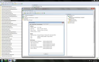

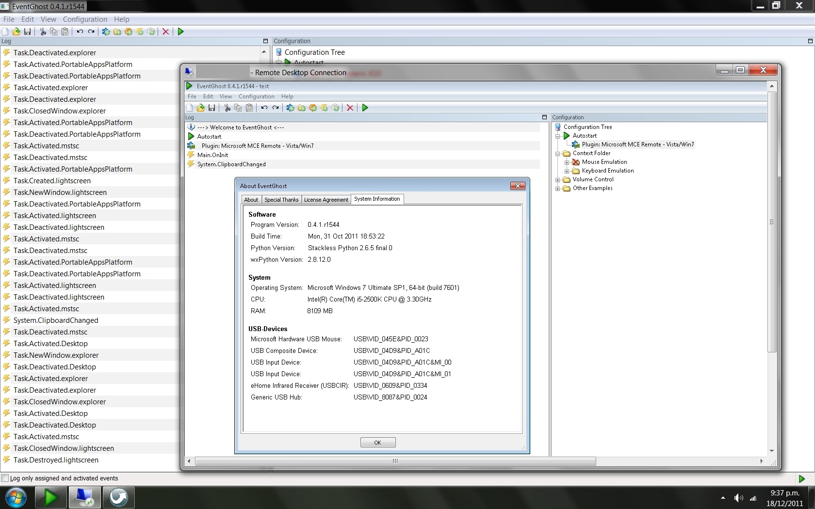

Hi, newbie to this forum and EventGhost. Seeking assistance in resolving an issue with EventGhost which does not seem to run properly on my newly built Home Theatre PC. I have browsed my way through this forum and have noticed that various peiple have had similar issues where EventGhost does not register the keys that are being pressed on my MCE remote (RC6). I have attached a screenshot of the system information displayed in EventGhost, of the machine in question. I have also attached a txt file of the output from the Event Viewer to assist.
I know that all my hardware is working prpoerly as I have successfully tested the same hardware on my laptop with no issues. I installed EventGhost with no issues, with all button presses being recognised in EventGhost as expected. The home theatre PC and my laptop are running the exact same versions of Win7 Ultimate (Build 7601 SP 1), the exact same version of EventGhost (0.4.1.r1544) and the same Microsoft MCE Remote - Vista/Win7 plugin.
The differences that come to mind are that the home theatre PC was used to test various plugins and has gone through a number if installs / uninstalls so it is likely there are remnants of plugins and EventGhost installs floating around in the home theatre PC, whereas the laptop has had one install of EventGhost and one install of the correct plugin. The failure of EventGhost to register events on the home theatre PC is not restricted to functions on the remote. It also would not register the launch of Windows Explorer whereas it did on the laptop but they both registered an addition to the clipboard.
I have uninstalled the "AlternateMcelrService" and reinstalled a number of time with reboots to the home theatre PC, but to no avail.
Any assistance would be appreciated. If you need any other info please let me know.
Andrew
Update on this post.....
I have since resolved this issue by reinstalling Windows. Bit of a sledgehammer approach but it has sorted things out.
Sceenshot of EventGhost &gt; Help &gt; About &gt; System Information
Sceenshot of EventGhost > Help > About > System Information
EventGhost Event Viewer 2011.12.18.txt
Txt output of Event Viewer
(8.14 KiB) Downloaded 319 times
