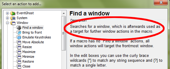

So what I want is to add a 'Find A Windows' action to ALL the macro's I created in my D-Box folder correct? If correct, let s test it with the 'Power Toggle' macro I created:
When I add an action 'Find A Window' I get to see this:
What I tried to do is this:
and this:
But it s not working. What am I doing wrong here?

THX-UltraII wrote: What am I doing wrong here?
Pako wrote:Sometimes the problem is to find the right (target) window (which accepts keystrokes). It may be a child window too.
Probably another window accepts keystrokes ...

Just tried all these without result. Maybe I m overlooking another setting or something I need to fill in somewhere?
See here for all the possibilities I tried: http://imageshack.us/g/861/62376035.jpg/
