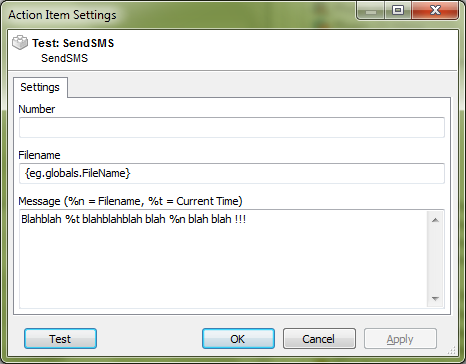

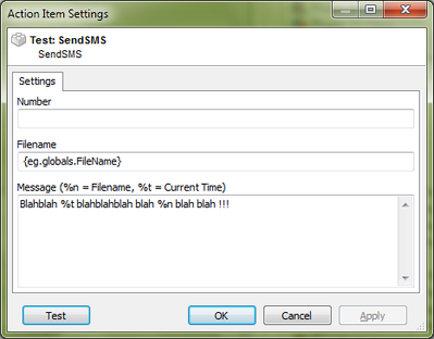

Correctly it should be done like this:Never would have an expression like eg.globals occur in the plugin source text !
class SendSMS(eg.ActionBase):
def __call__(self, number='', msg='', flnm=''):
try:
from time import strftime, localtime
msg = msg.replace("%n",eg.ParseString(flnm))
msg = msg.replace("%t",strftime("%H:%M:%S", localtime()))
self.plugin.voice.send_sms(number, eg.ParseString(msg))
except Exception,e:
print str(e)
print "Number is not valid"
def Configure(self, number="", msg="", flnm=""):
panel = eg.ConfigPanel()
numCtrl = panel.TextCtrl(number)
filenameCtrl = panel.TextCtrl(flnm)
msgCtrl = panel.TextCtrl(msg, style=wx.TE_MULTILINE)
msgCtrl.SetMinSize((-1, 100))
#msgCtrl.SetMaxSize((-1, 60))
number = panel.StaticText("Number")
filename = panel.StaticText("Filename")
message = panel.StaticText("Message (%n = Filename, %t = Current Time)")
panel.sizer.Add(number, 0, wx.EXPAND)
panel.sizer.Add((-1, 2))
panel.sizer.Add(numCtrl, 0, wx.EXPAND)
panel.sizer.Add((-1, 10))
panel.sizer.Add(filename, 0, wx.EXPAND)
panel.sizer.Add(filenameCtrl, 0, wx.EXPAND)
panel.sizer.Add(message, 0, wx.EXPAND)
panel.sizer.Add(msgCtrl, 0, wx.EXPAND)
while panel.Affirmed():
panel.SetResult(
numCtrl.GetValue(),
msgCtrl.GetValue(),
filenameCtrl.GetValue(),
) Pako
