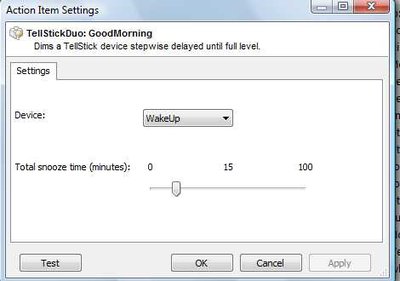

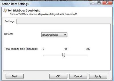

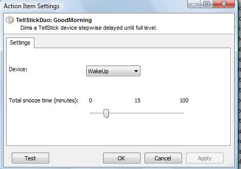

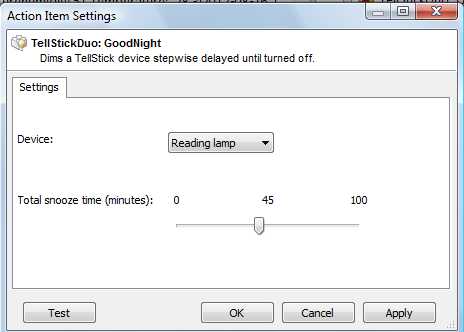

Re: Plugin: TellStick Duo
I have added some new actions to the plugin to allow you to control dimming of lamps in steps during a configurable snooze time. It is getting popular with so called wake-up lamps and here is a variant you could use (I call them Good Morning and Good Night).
It works like this:
You define the lamp control action and set a snooze time. Then when the action is triggered it will automatically dim the lamp in delayed steps during the snooze time (the action calculates the number of steps and each dim level required to cover the snooze time). The action can be triggered by any type of event when it is put into a macro.
It works like this:
