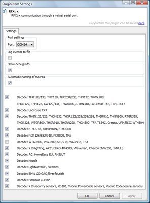

Connect and configure the RFXtrx USB transceiver according to the related documentation. All configuration are made with the tool RFXmngr that you also can download from RFXCOM.
Check that you have upgraded to latest firmware (the latest including the flash tool is also available for download at RFXCOM).
Once you installed the plugin and add it, you will see a view where you can:
- Select the com port that is used by the RFXtrx.
- Check the box if you would like to turn on logging to file.
- Check the box if you allow duplicated (repeated) events.
- Check the box if you would like to have detailed log information (debug level).
- Check the box if you would like to have automatic naming of macros.
- Check the box if you would like to use websockets (requires that you add Pako's new "Webserver with websocket support" or "Tornado" plugin.
The debug information is good to have, at least in the beginning, to see the raw messages or later if something is not working.

The following has been changed in this version:
- Added selection of supported protocols.
- Improved reading and decoding from COM port.
- Improved automatic naming of macros.
- Cosmetic bug fixing in some action configuration dialogs.
