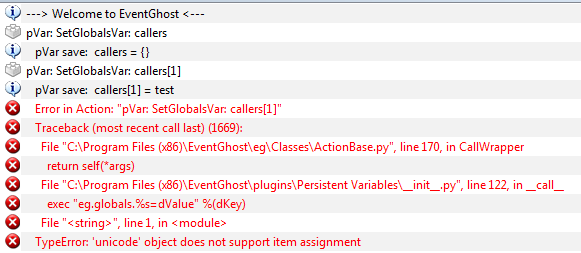

I tried the Persistent Variables plug-in:
Initial Config
Initial Config
It did not work. I get the following errors:
Log Error
Log Error
