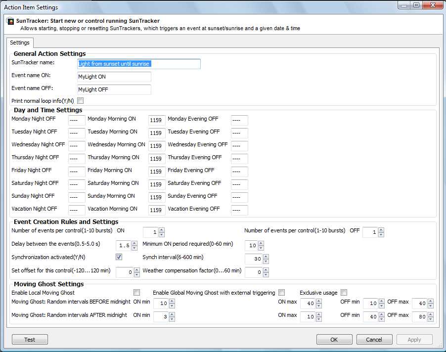

A simple question...
How do I set up "Day and Time Settings" to turn on the lights at sunset and turn them off them at sunrise? The lights are outside and should stay on all night.
Thanks.
Thanks.
You can do as in the example below. We have to set at least one time per day to get the thing going. Assuming sun is at its highest peak at noon, I put in 11.59. The lights will actually not turn on because the sun is up but the "logic" will start running.

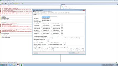

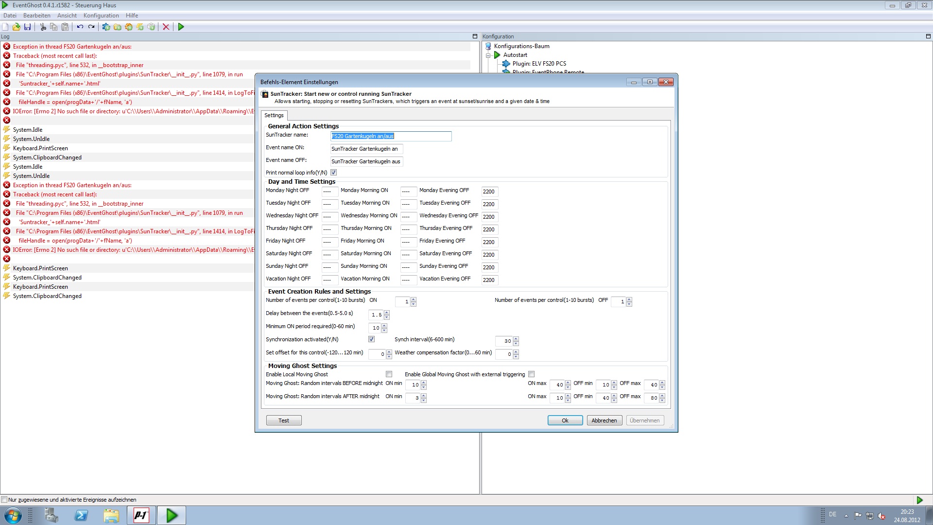

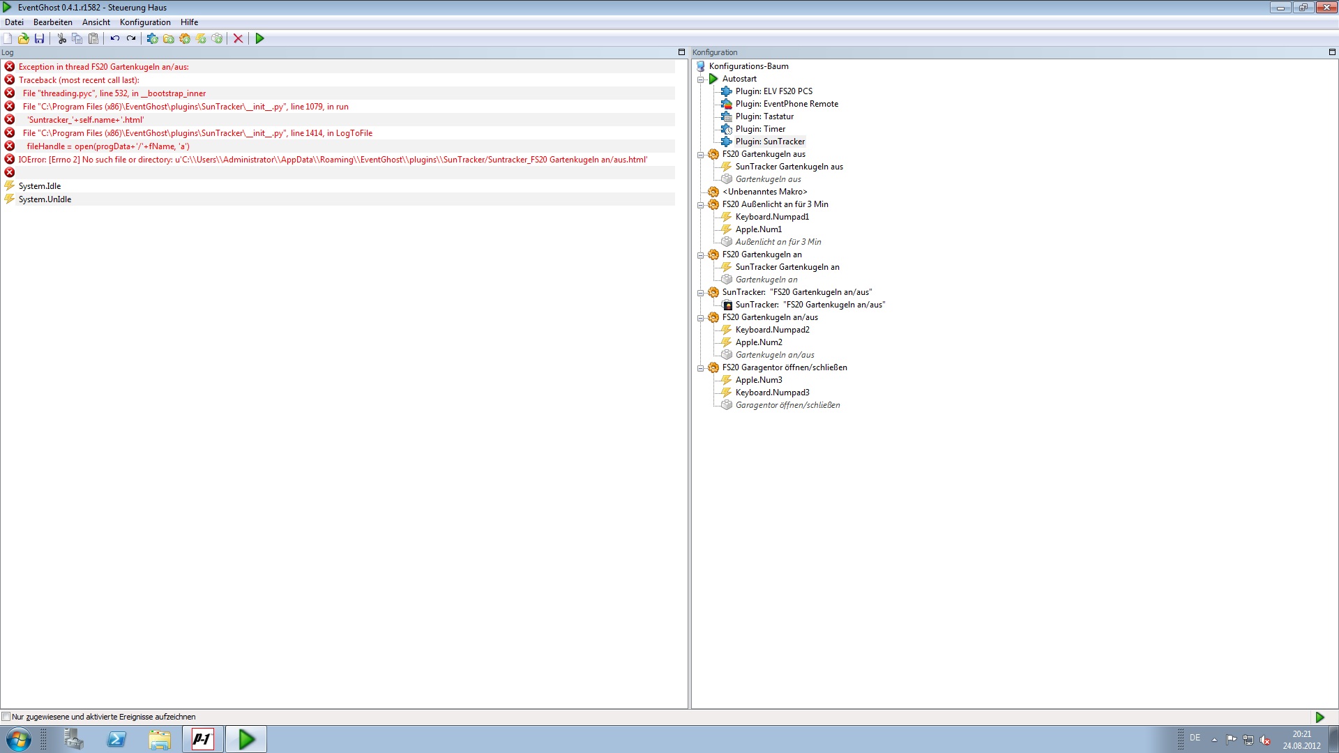

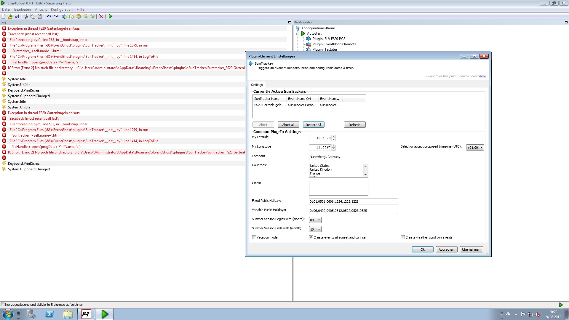

Dear all!
Every time I start the SunTracker Plug-in, I receive some error messages after a few seconds. I searched the forum and the net, but couldn't find a solution to it. I tried a few different versions of eventghost an suntracker, but without success. Perhaps it's because I'm new to the whole thing and have no experience? Is there anybody who can help me? Thanks a lot in advance!!!
Best regards
Rainer
Best regards
Rainer
I'll have the some errors. Anyone a solution?
The problem is that I do not handle all characters correctly. You named the thread "FS20 Gartenkugeln an/aus" and the character "/" will then be used incorrectlly.
Please try to rename it with another character instead like "FS20 Gartenkugeln an_aus" or similar.
