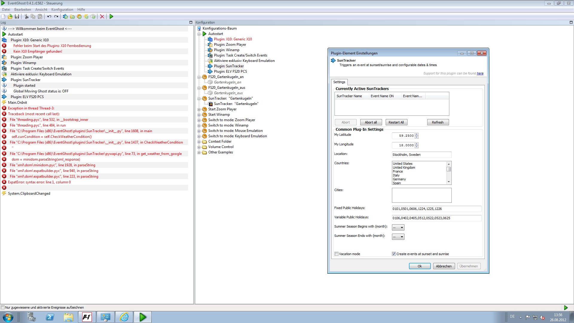

Dear Walter,
thanks for your suppport. It isn't still working, even without characters like "/" etc.
I uninstalled EG completly and started a new and clean installation(0.4.1.r1582). I added the plugin SunTracker (the version 1.2.4, which comes with the EG file) and created an macro for it. While setting up all the macros und the plugin for the FS20-Unit I received a few error messages. Then I closed EG and started it new. A few seconds after starting it, I get the errors shown in the picture.
I did a update of the SunTracker Plugin, but without success. There are still errors. Do you think there's a chance to get it running?
Regards
Rainer
You should use the latest version of the SunTracker found in the first post in this thread (the one included in EG is outdated).
The error problem you see now can be fixed with this:
download/file.php?id=2409

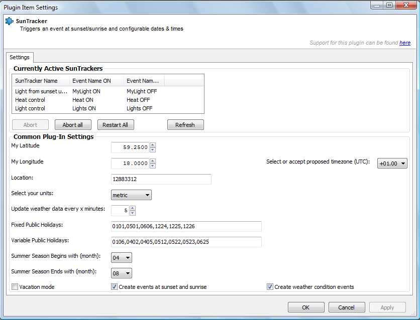

Right, the new version uploaded in the first post is now using Yahoo! Weather api instead. It has been running fine here since last night.
If you upgrade from previous version, you shall follow the steps as described below. Please unzip the content to the folder or at least copy the __init__.py and pywapi.py files since they are needed together and they are changed.
Upgrade procedure:
1) When EG is running current version, disable the SunTracker plugin and all SunTracker actions so that they all stops
2) Unzip or copy the content of the new zip file
3) Now configure the SunTracker plugin, as example look at the picture below.
- enter your location id: A five digit US zip code or location ID. To find your location ID, browse or search for your city from the Yahoo! Weather home page(http://weather.yahoo.com/) The weather ID is in the URL for the forecast page for that city. You can also get the location ID by entering your zip code on the home page. For example, if you search for Berlin in Germany on the Yahoo! Weather home page, the forecast page for that city is http://weather.yahoo.com/germany/berlin/berlin-638242/. The location ID is 638242.
- select your units: type of units. 'metric' for metric or 'non-metric' (currently planned for future functions)
- select how often you want weather data updates (default is every 5 minutes)
When finished, click ok, then enable the plugin so that it starts.
4) Now for each action, configure each of them by opening them and clicking ok
5) Enable each of the actions
6) Open the settings for the plugin again and check that they are all running
7) You are done!
