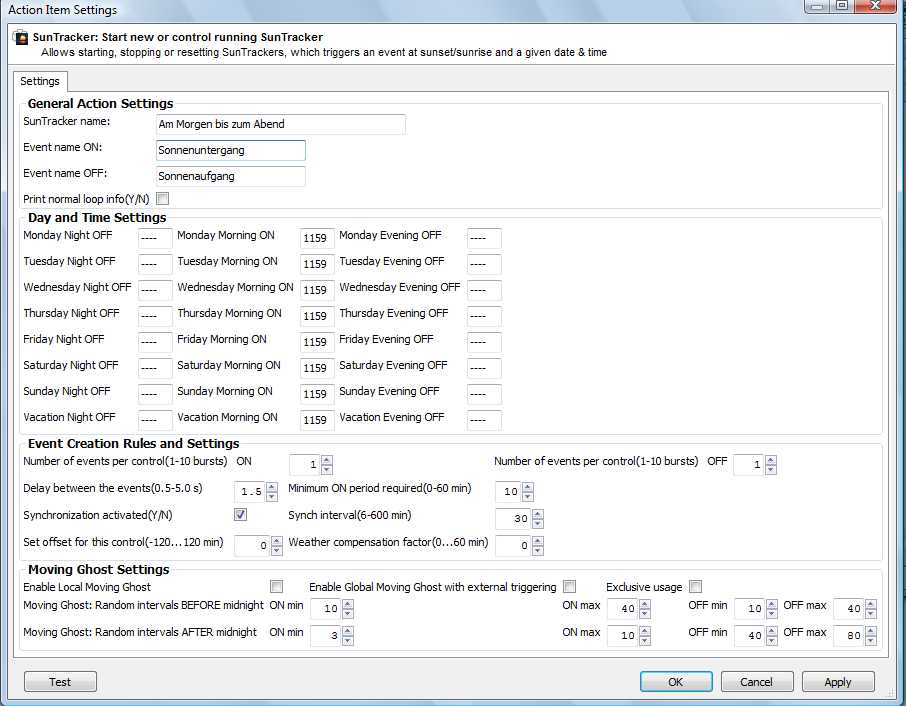

I just discovered SunTracker, but its very complicated for me.
I want to start an event at sunrise an start anotherone at sunset. Can someone please explain me how to arrange the right settins? Pictures would be very useful.
Thank you very much!
Deutsch ist auch ok wenn es leichter wird. Ich wird doch auf English antworten. Probier mal etwas wie es unten geseigt ist.
Gruss, Walter

Hallo, was passiert um 11:59 Uhr?
Ich habe es so eingestellt und die Systemuhr umgestellt auf 11:58Uhr, aber es passiert nichts.
Thank you very much. :wink:
Nothing really happens at 11:59,
any time setting is needed for the logic to start (could maybe be improved in a future version but this is how it is).
At 11:59 (at noon) the sun is up at its highest peak so nothing will be triggered. You will get a trigger at sunset and at sunrise and a sync every 30 min in between if you follow the settings in the picture.

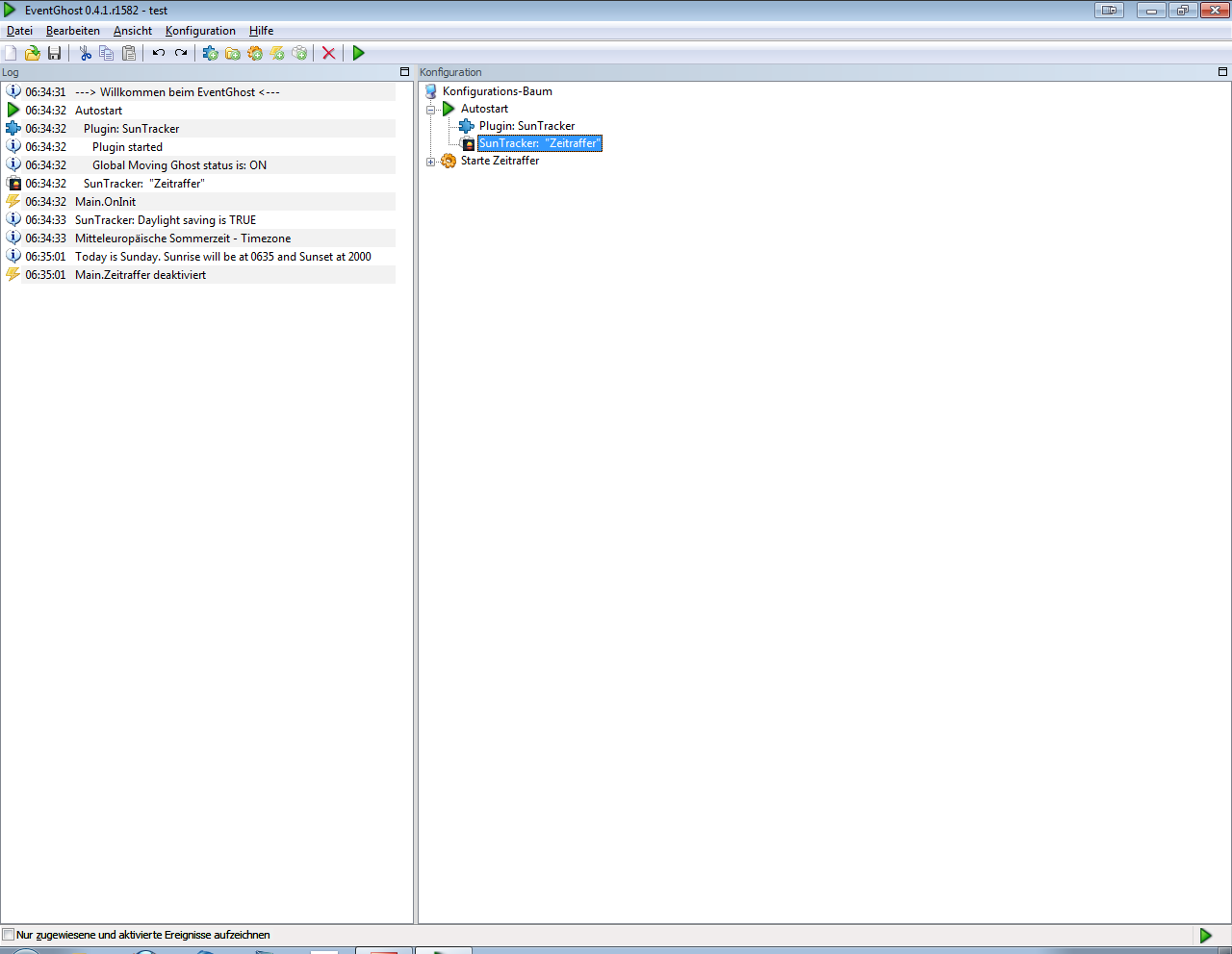

Habe alles genauso eingestellt, aber leider bekomme ich kein Sunrise Event!
Maybe a misunderstanding.
With those settings you will get an event at sunset and at sunrise. The name of the events will be what you have written in "Eventname ON" that will be triggered at sunset and "Eventname OFF" that will be triggered at sunrise.
In your picture you got an event with name "Zeitraffer deaktiviert" at 06.35, at sunrise. This is correct. If Zeitraffer would be a lamp, you would use this event to turn it off.
It is working correctly but maybe you are looking for something else. Please specify better then what you want to achieve.
If you just would like to have an event with the names "Sunrise" and "Sunset" you just put that in as names for "Eventname OFF" and "Eventname ON" respectively.
