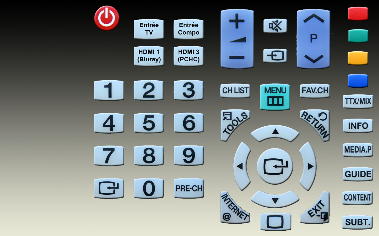

OK, a last issue with TerRemote :
Using this app, when my device (nexus 7) wakes-up after a period of inactivity, I unlock it with the "drag system".
The device returns automatically to TerRemote, but the background of the layout disappear.
Once again, I have to go in the layout-choice menu, choose a layout, and after this all become OK.
It's a big issue for me, because the background is a copy of my remote device...

this should not happen. Does this also occur with other, small background files and with shape-backgrounds?
polaris

Hello.
I have no problem with shape background.
I test with JPEG of 150 and 200 KB, each time with problèms...

I'll send you a PM to discuss this issue further. For your idea of a mouse control: I think EventGhost currently only supports to start/stop mouse movement which can be controled via a button already (using enduring events).
A trackpad widget is on my list but I don't know if it can control the mouse because of this issue.
