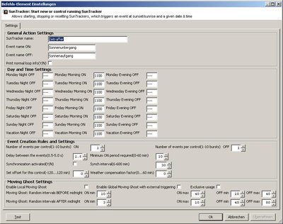

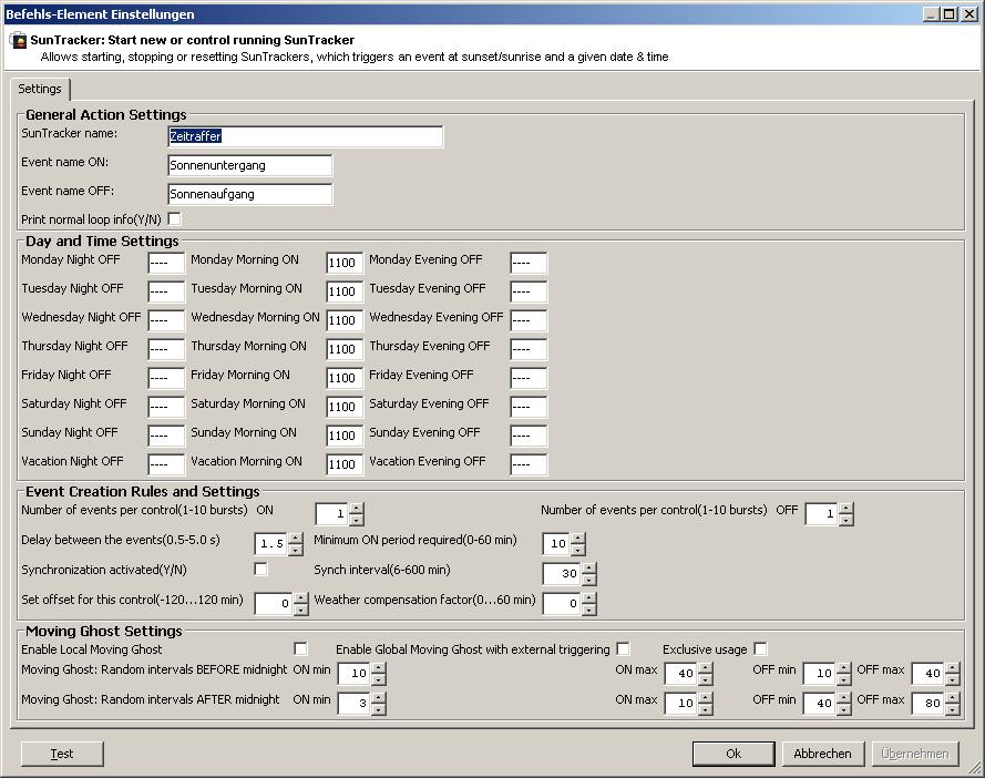

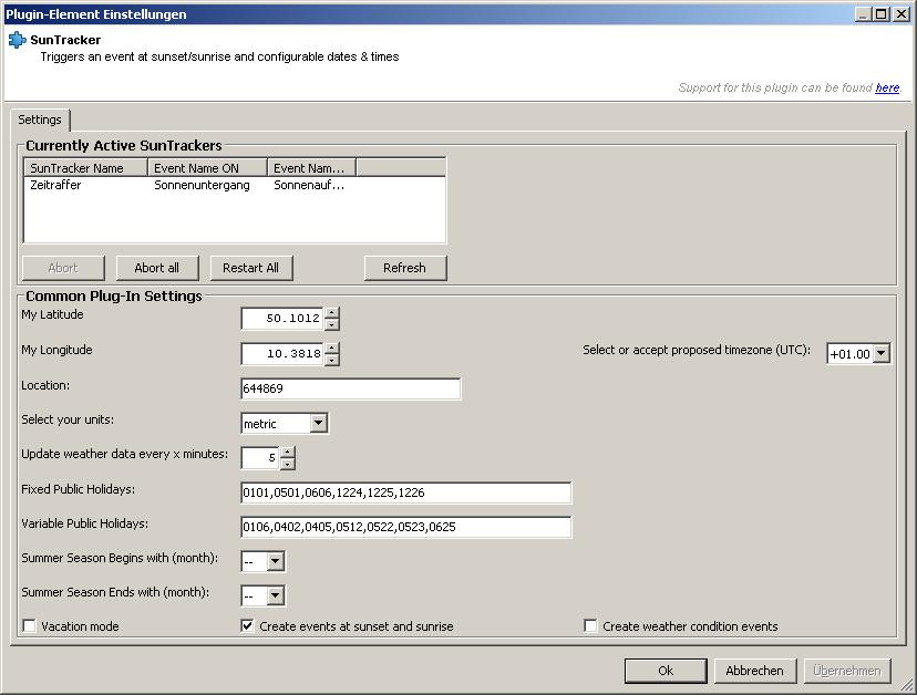

Could you post screen shots of your SunTracker and the SunTracker actions?
BR
cheater
Posts: 11
Joined: Mon Nov 24, 2008 8:54 am
Post by cheater »
Here we go,
hope thats all you need!

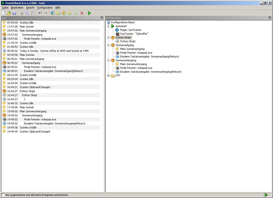

Thanks a lot, exactly what I needed, now I see the problem, just need to find how to fix it.
Actually, the action is doing everything correct, it is the Sunrise/Sunset events generated by the plugin itself that are wrong.
BR Walter
