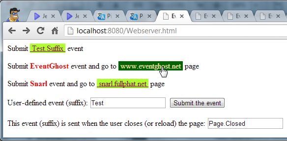

Re: How to fire an event without a button on the webserver?
Dear Walter!
I (completely independently of you) reached a very similar solution.
However, there are some differences:
1. I chose the POST method.
2. I did not deal with the different compatibility of the different browsers. My solution only works with Chrome and Firefox (and partly Opera). Opera does not support onbeforeunload event (so it can not work with you too).
3. My solution allows the user to submit events when navigate to another page (for each page you can select another event).
PakoExample.zip
(1.1 KiB) Downloaded 333 times
