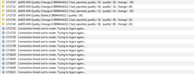

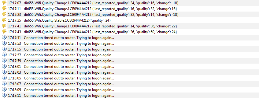

Here is a screenshot:

Cheers, I have one of these and gave it a go. I don't seem to get a disconnect, just the information message in the pic, until my mobile comes in range again.
