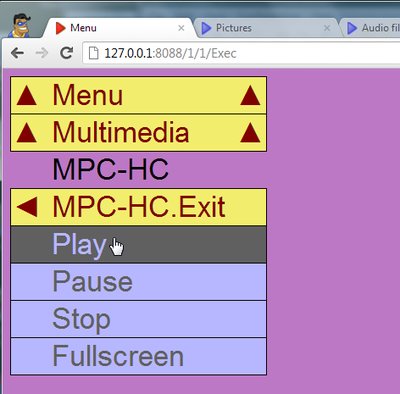

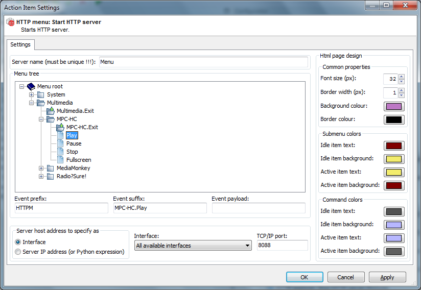

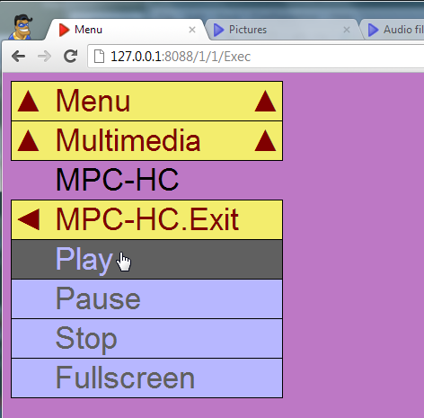

I finally finished the new (promised) HTTP menu plugin.
This plugin is similar to the plugin HTTP explorer.
Download here.
HTTP menu

Thanks Pako. I briefly tried it out and it works great. Would it be possible to create the Menu Tree using Pyhon expression (like the OS Menu plugin). Don't bother if it is too much work. I can imagine creating the sub-menu list would complicate the matter. Again, don't worry about it if it is not worth your while. It still looks good.
Thank,
Kalia
Thank,
Kalia
Re: HTTP menu
Yes, it would of course be possible.
But I doubt that it would have practical significance.
I mean, it would be very difficult to create a proper Python expression.
For example, for the menu, which is shown above, that expression would look like this:Pako
[u'Menu root', [[u'System', [[u'Go back to menu root', ['HTTPM', u'System.Back', u'']], [u'System.1', ['HTTPM', u'System.1', u'']], [u'System.2', ['HTTPM', u'System.2', u'']]], ['HTTPM', u'System', u'']], [u'Multimedia', [[u'Multimedia.Exit', ['HTTPM', u'Multimedia.Exit', u'']], [u'MPC-HC', [[u'MPC-HC.Exit', ['HTTPM', u'MPC-HC.Exit', u'']], [u'Play', ['HTTPM', u'MPC-HC.Play', u'']], [u'Pause', ['HTTPM', u'MPC-HC.Pause', u'']], [u'Stop', ['HTTPM', u'MPC-HC.Stop', u'']], [u'Fullscreen', ['HTTPM', u'MPC-HC.Fullscreen', '']]], ['HTTPM', u'MPC-HC.Start', u'']], [u'MediaMonkey', [[u'Go back to Multimedia menu', ['HTTPM', 'suffix', '']], [u'New item', ['HTTPM', 'suffix', '']]], ['HTTPM', u'Start_MediaMonkey', u'']], [u'Radio?Sure!', [[u'Go back to Multimedia menu', ['HTTPM', 'suffix', '']], [u'New item', ['HTTPM', 'suffix', '']]], ['HTTPM', u'Start_RadioSure', u'']]], ['HTTPM', u'Multimedia', u'']]], None]Re: HTTP menu
