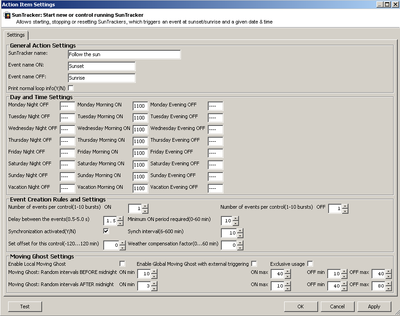

If i want to power on when sunset is and turn off when sunrise is, power on during whole night, how do I set it up then.
I have tried with ---- on everything but nothing happens.
I have to add at least OFF time, then it works.
Any ideas?
Any ideas?

Try to set '1100' on all days like belowIf i want to power on when sunset is and turn off when sunrise is, power on during whole night, how do I set it up then.
