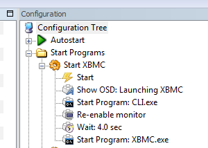

Try this thread:
viewtopic.php?f=5&t=2839&start=30#p23185
The screenshot is the relevant section, and the details are in the config file I posted in the other thread. Or you can do it with a TV connected event; details are in the same thread.
- Capture.PNG (13.09 KiB) Viewed 5545 times
