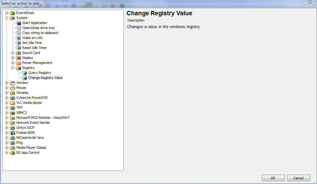

What if you use EventGhost's built in registry changer, rather than a batch file? Do you still need to use sysnative trick?jonib wrote:I'm suspecting your problem is that EG is running the 32bit version of Regedit, so the registry is update in the wrong section if you are running on a 64bit Windows.
Re: Win7 SpeakerConfig Registry Key Batch File
By default a 32bit program can't access the 64bit part of the registry.blaher wrote:What if you use EventGhost's built in registry changer, rather than a batch file? Do you still need to use sysnative trick?
There is a parameter KEY_WOW64_64KEY that needs to be used to access the 64bit registry. I don't know if EventGhost uses that.
