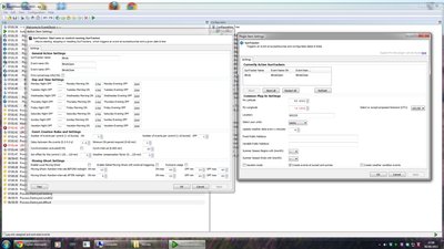

i cant seem to get this plugin to do anything useful. So far i've got it opening my blinds and closing them but it only ever seems to do it the wrong way round, opening them at night and closing them in the morning even if i switch the event names around, and flipping between opening and closing them constantly. I don't know what going on.
If i just have a "start new or control running suntracker" with my longitude and latitude programmed in, should that be creating an event for sunrise and sunset? what will the events be called? the same as the events i have in place for Event name on / Event Name off?
Try to publish some screen shots of your configuration,
Best, Walter

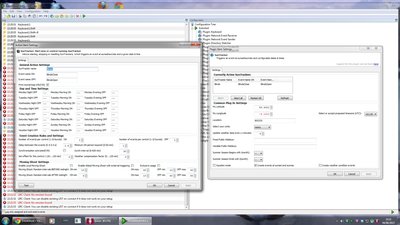

this is what my setup is now, and it doesnt seem to do anything. I did previously have 0700 for every morning on, and 2000 for every evening off. and had synchronize on, but that seemed to just make it constantly open and close the blinds.
and i keep getting things like
22:32:02 Next execution of Blinds will start in 60.7076006589 seconds 0
but nothing happens
To get rid of the message you receive every minute, uncheck the box 'Print normal loop info (Y/N)'.
Set all 'Morning ON' times to 1100 (a time is needed to make the thing work, at 1100 the sun should be up and therefore this would not have any other negative impact. I know this is maybe not perfect but this is the way it works)
You should then get events like this:
- at sunrise, the 'Event name OFF' will be triggered, in your case 'BlindsOpen'
- at sunset, the 'Event name ON' will be triggered, in your case 'BlindsClose'
You have to drag those events to macros that will have the actions to actually control your blinds (I assume you have this already)
(To simulate, you can adjust the system clock accordingly and set it just before the triggering is supposed to happen)
Best, Walter
