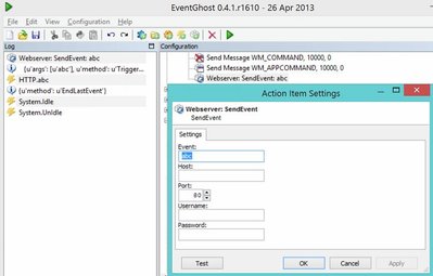

Does anybody have any documentation on sending events with the eg webserver? examples? I can't seem to find anything.

Sending Events to the webpage FROM eventghost, the only plugin action that is listed with the webserver plug in.

Its not for just creating an event within eventghost, you can send back data to the webpage using an ajax request I believe, I tapped my internet using wireshark, there seems to be outgoing traffic when using the SendEvent Action (that's why there is a host IP address option box), I want example code on the client side of responding and acting on this received response.

The Host entry in the Webserver SendEvent configuration allows you to send an event to another computer running EG and the Webserver plug-in. An Event is generated on that Host computer.
Perhaps someone else understands what you are trying to do. I do not.

I just had the same "problem".
It seems like the EventGhost webserver SendEvent can only send data to another EventGhost using webserver - what is in my eyes kinda useless, there are other plug-ins which can do that better.
Anyway, since I had the same problem I changed the webserver plugin a bit - with my modification you will get a new event SendEventExt which can send events to other webserver.
Also I rewrote the "do_POST" block as it didn't work for me.(I was not able to send POST requests to EventGhost, only GET worked. Now both are working.)
If you have the same issues, check it out!
