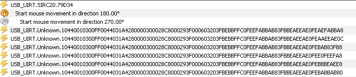

I am trying to use the Start mouse movement in direction feature to navigate my mouse to a button on the screen. When I press and hold the button on my remote once, it sends a IR command to the receiver which I can use to make the macro. Perfect. However, when I hold and press the button my remote it sends a series of IR commands, each one different then the next.
Has anyone experienced this before? How can I get my mouse to move continuously if the IR signal changes each time? Is there a way to capture several IR commands (notice how all of them start with Unknown.10044...)

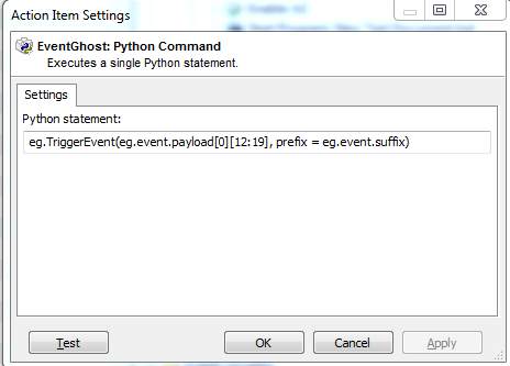

You can use a python command like below to specify the characters you're interested in every time a trigger of USB_UIRT.Unknown, is received. Just change the range from 12:19 to the appropriate values to capture the 'Unknown.10044', and use that as your mouse trigger.
