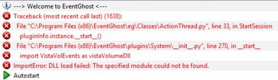

I'm using Win7 x64, and since I installed the latest version r1638 I have an error on EG startup (the previous version r1630 was OK there was no errors), see below :
15:47:53 ---> Welcome to EventGhost <---
15:47:53 Traceback (most recent call last) (1638):
15:47:53 File "C:\Program Files (x86)\EventGhost\eg\Classes\ActionThread.py", line 33, in StartSession
15:47:53 pluginInfo.instance.__start__()
15:47:53 File "C:\Program Files (x86)\EventGhost\plugins\System\__init__.py", line 270, in __start__
15:47:53 import VistaVolEvents as vistaVolumeDll
15:47:53 ImportError: DLL load failed: The specified module could not be found.
15:47:53 Autostart
15:47:53 Plugin: Keyboard
15:47:53 Main.OnInit

I'm also getting the exact same error message at startup that I wasn't getting with r1610. Win8 x64
Edit: Actually, I'm getting the error on one PC, but not the other; both Win8 x64.

In addition to the above error, I am unable to use any action under System.
I have Win 7 Pro x64 and EventGhost 0.4.1.r1630 did not have this problem.

I get the ERROR too (both)..
Plugin "System" ist nicht aktiviert
which means "Plugin "System" is not activated"
It happens, for example, when I try to run an application from EventGhost.(like kalia just showed)
Also I have Two "System" loaded somehow, and none of them work...
EDIT: I have Win 8 Pro x64 - v4.0.1.r1630 worked

Fortunately, the exact same error with solution was posted earlier. Download/extract the attachment and "copy VistaVolEvents.pyd to the plugins\system folder." It worked for me. I'll leave it to the experts to figure out why the error cropped up with this release.

As noted by kkl, this has nothing to do with the changes I made -- it's simply a matter of VistaVolEvents.pyd not being present, which suggests an installer issue. That said, both an upgrade and a clean installation installed the file in question on my system, so I'm unable to shed any additional light.

Alright, got it -- the original author of VistaVolEvents didn't enable static linking in the project configuration, and because I built it with a newer version of Visual Studio than he did, the version in r1638 requires a dependency that some may not have.
Attached is a statically linked version that should work everywhere. I suggest you push this out immediately as r1639, Pako.
patch.zip
(42.89 KiB) Downloaded 301 times

Thanks Pako & Blackwind ! r1640 is working now with no errors ! Thank you !
