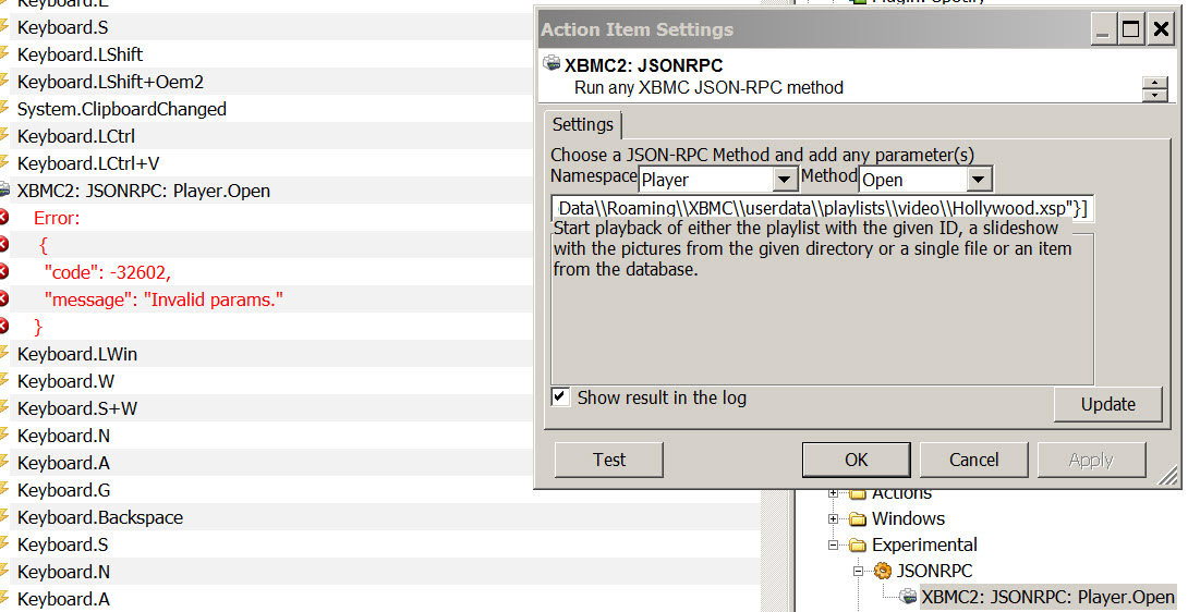

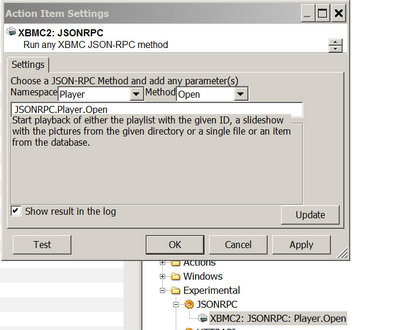

Yes i am using the correct test file per my version. Currently i am on this window. (please see attachment)
Using an example of one of the Playlist.. does the below syntax look good.. with all the double quotes, braces and cornered brackets and double slashes?
[{"file":"C:\\Users\\Admin\\AppData\\Roaming\\XBMC\\userdata\\playlists\\video\\Hollywood.xsp"}]

Looks like my syntax is wrong...
I already got this error when i tried with the above commands... that i posted in this thread earlier.
Error:
"code": -32602,
"message": "Invalid params."
Almost on the edge, i guess i am very close.. please help.

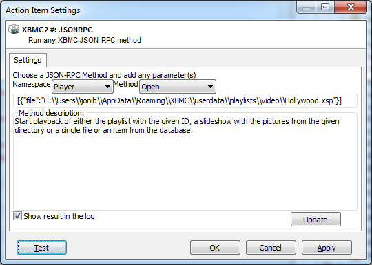

MANswers wrote:Looks like my syntax is wrong...
So I used this:
only changing the username, and I placed a file in that path (I keep my XBMC files on my D: drive). And it works.
I did get the same error you did before I changed the username, as I forgot to change it.

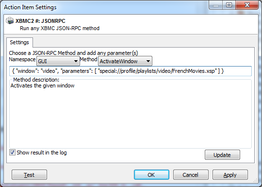

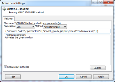

I got someone to reply at XBMC forum, and they mentioned something like this...
{"jsonrpc":"2.0","method": "GUI.ActivateWindow", "params": { "window": "video", "parameters": [ "special://profile/playlists/video/FrenchMovies.xsp" ] }, "id": 1 }
I think this will need modification to be added to our plugin.. right?
MANswers wrote:I got someone to reply at XBMC forum, and they mentioned something like this...
Good call.
Just copy the "params" part and put it in:
I just tried and works great. (of course I changed to a playlist I have)

Post by MANswers »
jonib, you are a genius bro!! This worked perfectly fine.
I can open all my 7 movie genre playlists through irule (remote application on ipad).
