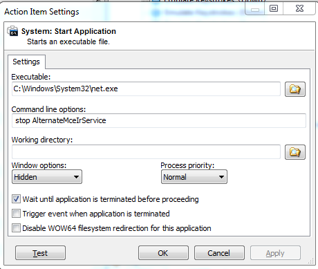

Sure, just use the 'find window' which you've already discovered, then use a mouse click on the exit button, or send an (alt+f4). It could be a service rather than an .exe that needs ending too, in which case use the pic below as a guide and substitute AleternateMceIrService with the logitech service name.Madderikk wrote: Is there a possibility to create a macro that closes the profiler manually (with automated key hits or mouse movements or something like that)

Other than that I can't find the adressed Logitech service name or it just doesn't work (I used LWEMon and Logitech instead of 'AlternateMceIrService" in the command line).

Re: Killing a process when starting a program
You need to find the correct service name to have a chance. Type services.msc into the Windows search, sort by status, and look for any Logitech/Game/Profile sounding stuff that is 'Started'.
viewtopic.php?f=2&t=3987#p22917 might help if it doesn't work after you find the service name.
