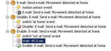

I connected some wireless light switches to EG and can activate them acoording to scenes I created. Now I would like to set a motion sensor to send me an Email when movement is detected but only when I am not at home. The "not at home" mode will be activated through a wireless switch that sends an event to EG.
My question is how can I check to see if the event "not at home" was triggered and after that monitor the motion sensor and as soon as movement is detected Email is sent.

You could try a configuration similar to this:
What will happen is that when you are leaving home, you operate the switch and it sends a signal that triggers the 'away' macro. After the delay of 45 seconds (that gives you enough time to close and lock the door), the macro for email activation will be enabled.
If movement is detected by your movement sensor, an email will be sent (in this simple sample, an email will be sent for every detection as long as you are away, so don't allow your dog running around while you are away)
When you arrive home, you operate the switch in opposite direction, the 'at home' macro will be triggered and the email macro disabled.
BR Walter

Thanks. So simple!!! I wasn't aware of the actions Enable/Disable.
