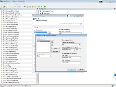

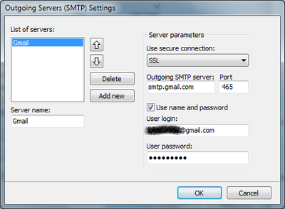

I am trying to activate E-mail plugin with Gmail but get this error
SMTP Protocol Error: Cannot connect to SMTP server "smpt.gmail.com:465"
1. My FireWall disabled ,
2. i tried port 25 instead of 465
3.I tried connect with Telnet and it looks connected.
Please help

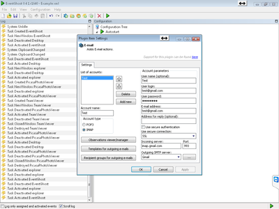

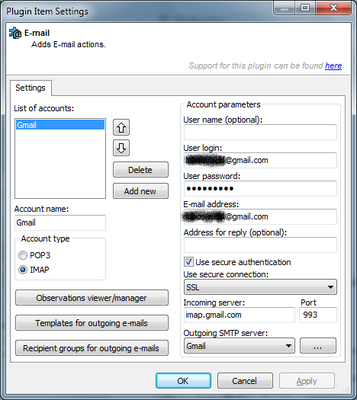

I opened a new file in EventGhost, I added E-mail plugin and I configured it as follows:It worked on the first try.
I think that the problem must be elsewhere than in EventGhost or plugin.

I use the last version that was published here (post from 2013 4 24 Wed, 09:37).VADIM wrote:Hi Pako
Thank for answer .
May be you can send me plugin " E-mail " you are using.
Yes, I prefer to use IMAP if possible.VADIM wrote:I also see that you using IMAP instead of POP.

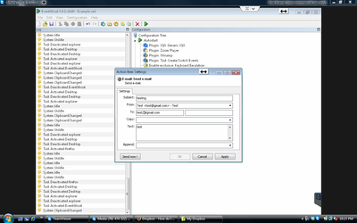

I tried the newest plugin , but without the success.
My be problem in my Email Action configuration , can you please send me example .

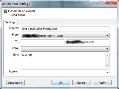

I highly doubt it.VADIM wrote:My be problem in my Email Action configuration , can you please send me example.
However - here is an example of an action that sends an e-mail.

can anyone advise if this plugin is working??..I have downloaded it from the link and added it. I have read through all the posts and but can not get it working. I install and configure using imap for gmail, when I try to setup a send email action, the "ok" box is always not clickable although I filled in all required fields. This is also the case for start observation...thanks for any help that can be offered.

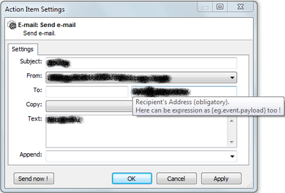

This means that you have it configured incorrectly.dacari wrote:when I try to setup a send email action, the "ok" box is always not clickable although I filled in all required fields
But we do not know why.
You can put screenshot?
Re: E-mail
AAhhh...silly me!!..it works!!..thank you very much
