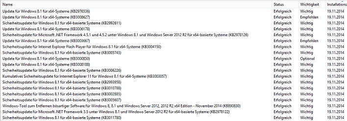

Hey guys,
since I updated my system a couple of days ago Auvisio isn't working for me any more.
I am on Win 8.1 Pro and installed the following patches.
So now if I noticed my remote isn't working any more and when I try to activate it in eg I get

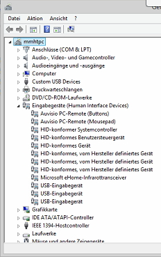

Auvisio is listed as a HID device in the system manager
Anyone of you have the same?
