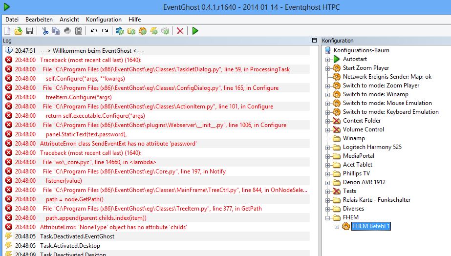

I┬┤ve tried to use this action already.
I┬┤ve first installed the Plugin.
If I click -> Add Action... -> Webserver -> Send event to another webserver
There appears lots of errors in the log, but there are no parameters to set up.
Do you know, how to use this Action?

I've not seen that windows before.
When I klick "send event to another Webserver" to add an action, only the errors in the log appears.

I┬┤ve used the version included in EventGhost_0.4.1.r1640_Setup.exe
With Version 2 of WebServer plugin, everything works fine. That saves a lot of work for me.
