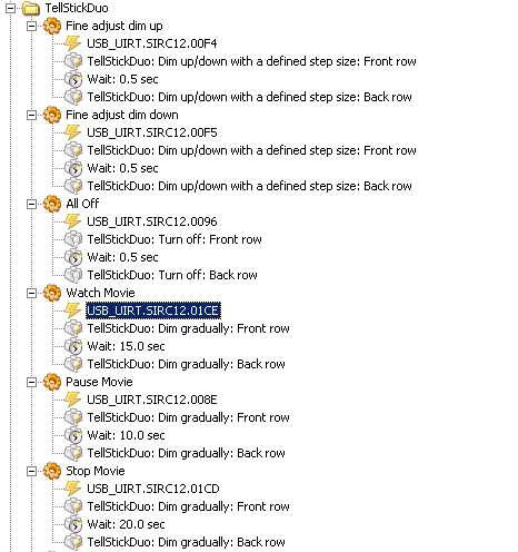

In essence, I would try something like this:
a) Group the 'dim gradually' actions for devices you like to control with one button press into the same macro (add a ''Wait" between each action if you have devices with different addresses, long enough so that the previous action can finish before the next starts). You can imagine the macros as a 'scenarios'
b) Create one macro for each scenario you need, 'Watch Movie', 'Pause', 'Stop', 'End', 'All Off' etc
c) Add actions to each macro (you can copy from one to the other and then change the configuration of the copies)
d) Assign one remote button for each macro (if you use a standard remote, you could use the normal 'play', 'pause', 'stop', 'off' etc buttons)
e) The actual configuration of the dim level for each device in each scenario you have to set in the corresponding action

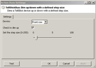

f) Create an additional fine adjust macro for 'dim up' where you put a 'dim percentage' action for each of the device addresses you use and configure them with the same step size. Assign one remote button for 'dim up'
g) Do the same for 'dim down'. Assign one remote button for 'dim down'
Below some pictures that shows a simple example of the above.

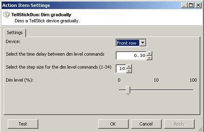

Re: TellStick Duo
Sample simple configuration of macros, events from remote and actions
Sample setting for the fine adjust step up action
Sample setting for the dim gradually action to dim to specified dim level
