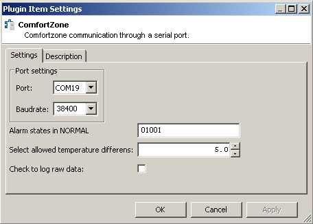

It is very simple to configure:
Just select the com port that is used for the communication with the Comfortzone and set the proper baud-rate.
Check that the alarm mapping for NORMAL status is correct for your model of heat pump (the default is ok for newer models). Otherwise modify it.
Also, set the allowed temperature difference between actual and set as explained above
If you are interested in looking at the raw data, I have provided a check-box that you can tick
There is also an action that you can use to simulate the alarms (otherwise it would be difficult to configure further macros and actions and to test them properly).
