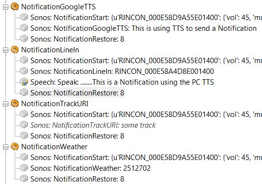

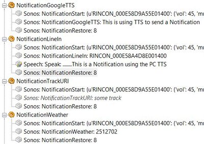

check this plugin out:
http://eventghost.org/forum/viewtopic.p ... 2cb6e60cd3
this could make for all kinds of notification triggers as well.

How to use notifications:
Refer to image below to see how notification actions need to be configured.
Notifications
Notifications
1) All notifications should start with NotificationStart
this notification allows you to select which ZPs the notification goes to, set the volume, and decide if you want to over ride the current mute state of the ZP. This action also stores the current ZP music state.
2) Send the actual notification using one of the notification actions (GoogleTTS, LineIn, TrackURI, or Weather)
if using LineIn, then you'll need another action after this one to play the notification through the selected ZP's Line In (in most cases this could be your PC connected to Line-In and you use the Speech plugin to have the PC handle TTS)
3) All notification should end with NotificationRestore
here music is restored to the state before the notifications were started. This is also where you place the delay in which the plugin will wait to restore the music. The delay is based on the time it takes to play your notification.
