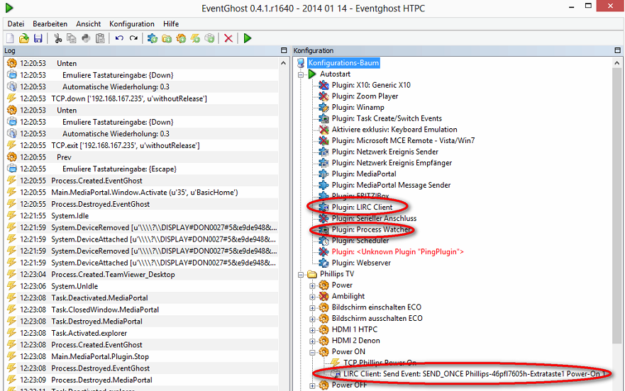

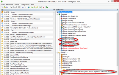

I solved a similar requirement to send IR Codes to my TV and Receiver.
Therefor i┬┤ve installed the Plugin "Process watcher" in Event Ghost, to get events fom the PC like "window changed" or "go to sleep".

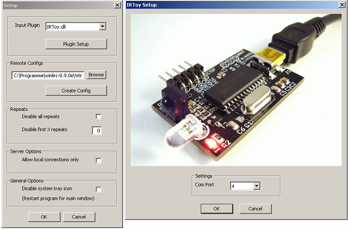

My IR Transmitter "IR Toy" is connectet via USB to my HTPC. It┬┤s controlled and programmed with WIN LIRC.
To use the events with the IR Transmitter, I┬┤ve installed the Plugin "LIRC Client"
So Event Ghost can control WIN LIRC.
Maybe you can use your HP Transmitter in a similar way.
Although because of the alignment of transmitter and receiver, I use 2 different devices for the sending and receiving.
I┬┤dont know if ther is an easier way to get the transmitter work in Event Ghost.

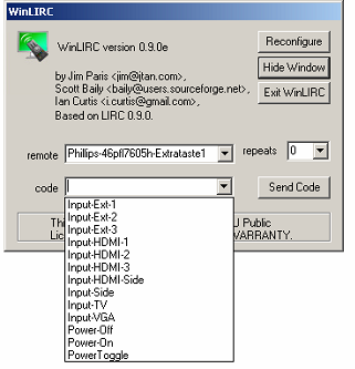

In the WIN LIRC Setup you can declare your device and create a IR-Config with all required IR-Codes
Win LIRC with all teached commands an possibility to test the commands
WIN LIRC.png (41.12 KiB) Viewed 3973 times
Event Ghost with all required Plugins to trigger IR-Codes on WIN LIRC
