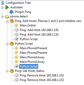

1. I would use the ping plugin if you will have your phones always connected to the network. Otherwise BT or something could be used.
2. This just requires some scripting.
phone check config.png (17.11 KiB) Viewed 5162 times
<EventGhost Version="1544" Guid="{25A9A0C5-0D7E-4D93-B04B-1D4C52118B30}" Time="1362099865.79">
    <Autostart Name="Autostart" Expanded="True">
        <Plugin Identifier="PingPlugin" Guid="{E0E0AFD7-31D5-41FE-B9DA-237234DB07A7}" File="Ping">
            gAIpLg==
        </Plugin>
    </Autostart>
    <Folder Name="phone detect" Expanded="True">
        <Macro Name="Ping: Add Hosts: Phones 1 and 2 and initialize vars" Expanded="True">
            <Event Name="Main.OnInit" />
                PingPlugin.AddHost(u'192.168.1.151', u'Phone1', 200, 60, u'Phone1Present', u'Phone1Away', 1, 1)
                PingPlugin.AddHost(u'192.168.1.152', u'Phone2', 200, 60, u'Phone2Present', u'Phone2Away', 1, 1)
                EventGhost.PythonScript(u'eg.globals.Phone1Status = "Away"\neg.globals.Phone2Status = "Away"')
        <Macro Name="Python Script" Expanded="True">
            <Event Name="Main.Phone1Present" />
            <Event Name="Main.Phone2Present" />
            <Event Name="Main.Phone1Away" />
            <Event Name="Main.Phone2Away" />
                EventGhost.PythonScript(u'x = eg.event.suffix[5:]\nprint x\n\nif x == "1Away":\n    eg.globals.Phone1Status = "Away"\nelif x == "2Away":\n    eg.globals.Phone2Status = "Away"\nelif x == "1Present":\n    eg.globals.Phone1Status = "Present"\nelif x == "2Present":\n    eg.globals.Phone1Status = "Present"\n    \n    \nif eg.globals.Phone1Status == "Away":\n    if eg.globals.Phone2Status == "Away":\n        eg.TriggerEvent("TurnOnCameras")\n    else:\n        eg.TriggerEvent("TurnOffCameras")\nelse:\n    eg.TriggerEvent("TurnOffCameras")')
        <Macro Name="Ping: Get Hosts Status" Expanded="True">
                PingPlugin.RemoveHost(u'192.168.1.151')
                PingPlugin.RemoveHost(u'192.168.1.152')
ping tested.xml
(2.15 KiB) Downloaded 227 times
