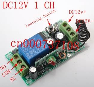

New version released in first post. Long time wanted support for potential free 12V and 220V relays added, Lighting5 ÔÇô Aoke relay.
The Aoke 12V DC - 315MHz or 433.92MHz 1 channel relay is available at http://www.aliexpress.com store No.110758.
Indicate clearly the required frequency when ordering!
The 1 channel learning relays can be used, see the picture below.
For example, for 1 relay order:
http://www.aliexpress.com/store/product ... 34863.html
or for 6 relays:
http://www.aliexpress.com/store/product ... 06574.html
The jumper next to the learning button defines to operating mode:
Open = momentary
1-2 = toggle mode
2-3 = on/off mode (to be used with the RFXtrx)

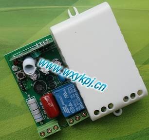

A 220V version is also available:
For orders:
http://www.aliexpress.com/store/product ... 68101.html
or for 6 relays:
Open = momentary
1-2 = toggle mode
For orders:
