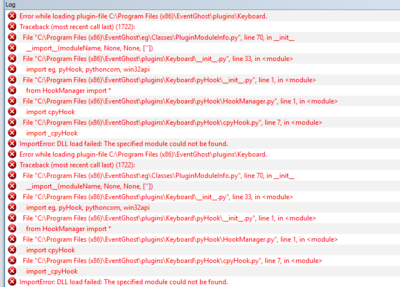

It is likely something wrong with my setup, so I have decided to delete everything and start fresh. And now I'm stuck on this error. Any idea?
Re: Keyboard+
So if you read each line and think about it, where would you guess it goes wrong!??

Well it is obviously a DLL or some other component missing. But I don't remember ever installing any additional component when installing this plugin, just grabbing source from github, replacing old Keyboard plugin and it worked.
blackwind
Posts: 182
Location: Canada
Re: Keyboard+
Post by blackwind »
The repo currently contains the Python 2.7 version of pyHook, which won't work in the stable version of EventGhost. Try the previous commit.
