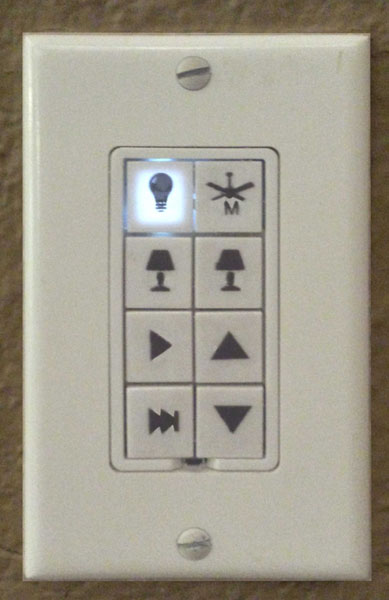

I have 8 btn keypadlincs but I don't have them setup like smarthome shows them (low, med, high, off). It made more sense to me to just have low, med, high and to turn it off you just press the button that is on. I did that for a little while until i needed my keypad buttons for more things so now my keypad just has med. If I want to set the fan to low or high i use the insteon hub app or could use EG to do this as well.
All functions will work through the plugin once you setup links between the fanlinc and the PLM that is connected to EG. Though, i don't think the fanlinc supports forward and reverse. If you want insteon to control that you would probably have to get one of the mini insteon modules and wire it into your reverse/forward switch on the fan.
my current keypad is configured like this:
A= fan light (off/on/dim/brighten)
B= Fan (med/off)
C= Hue lights (use EG to set the color and brightness depending on the time of day, if its late at night it turns purple so you can see but not be blinded with a bright yellow light) (dbl tap turns off)
D= (future blinds control, open, close, adjust)
E= SONOS Play (dbl tap Pause)
F= SONOS Vol+ (dbl tap set volume to 65)
G= SONOS Next (dbl tap previous)
H= SONOS Vol- (dbl tap set volume to 33)
Keypadlinc example
Keypadlinc example
I have many other keypads where i'm doing similar things as well.

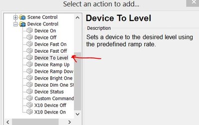

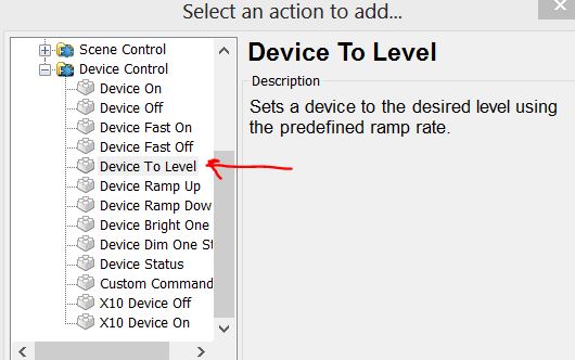

I have been able to get my lights to turn off on start of movie, on with pause and on with stop using my remote. I would like to have the lights dim on pause rather than on bright. I am using the 2412n. Can anyone help with this? Thanks in advance.

Hi lja,
try using the device command that sets it to a specific value. This of course is assuming you are using a dimmable light switch.
The other option is to setup a scene with the desired level and use the scene on command recalling the scene you setup.
Hope this helps.

Thanks @ techoguy. Appreciated. Got it to work using device command.
