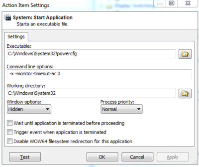

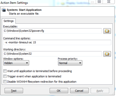

V_J wrote:Nice one! Might be interesting in my case, when playing back audio through hdmi, but it stops when the screen goes to sleep. Rather than keep the pc awake, I might opt to switch audio device...
Another option is to have 2 macros, each triggered by events from the creating and ending of whatever audio program you use, and then use powercfg to either enable monitor sleeping (after 15 minutes in the example below), or disable it.
Edit: Oops, I see you've already list the idea of keeping the PC awake, but I will leave this here in case it helps someone else.
