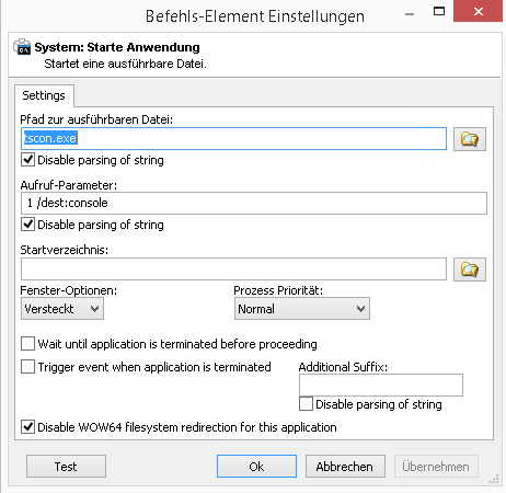

The Problem is, that the press of "a" and so on is executed in your user context - but the lock screen has no user context.
I'm using tscon.exe to unlock my PC.
Use the System -> Execute function of EventGhost like this:

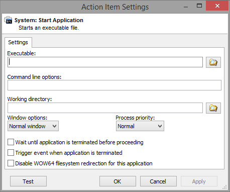

Thanks Sem;colon, I will give it a try. Is that just the Add Action > Start Application > ? as my dialog looks a litte different.
Re: Windows 8 unlock PC
Yes, it looks a bit different because I use a modified version of this system plugin:
viewtopic.php?f=10&t=6195
Thanks for the reply. So do I need your modified version in order to make it work? Do I create a folder in Plugins called Execute and then add new plugin, sorry still finding my feet with EventGhost
If I run "tscon.exe 1 /dest:console" via the command Window (as admin) I get the following:
- Capture.PNG (7.77 KiB) Viewed 9492 times

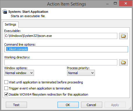

mikeparkie
- Posts: 17
- Joined: Wed Jul 30, 2014 9:53 am
Query Session says the session is "1" and I modified EventGhost to launch as Administrator but it's still not working, although the arguments appear to be correct. I have attached the screenshots to show how I have configured it at the moment. A screenshot of your setup would help?
Again if I run the following in an Administrator cmd I still get the following:
Could not connect sessionID 1 to sessionname console, Error code 7045, Error [7045]:The requested session access is denied.
Any idea if EventGhost is launching tscon with admin permissions, I assume if you launch EG with admin then it should have the necessary admin permissions.
