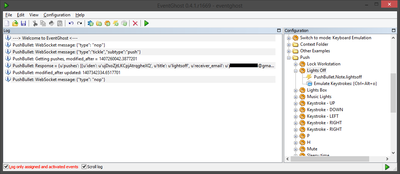

Macros are not being executed.
PushBullet: Push to everything: note to Everything
PushBullet: Response = {u'pushes': []}
PushBullet: WebSocket message: {"type": "nop"}
PushBullet: WebSocket message: {"type": "tickle", "subtype": "push"}
PushBullet: Getting pushes, modified_after = 1407091894.6200600
PushBullet: Push results: [{'device_iden': None, 'type': 'device', 'nickname': 'Everything', 'ok': True, 'push_iden': u'ujDxoZjtLKCpjzYO1AGpB6'}]
PushBullet: Response = {u'pushes': [{u'iden': u'ujDxoZjtLKCpjzYO1AGpB6', u'source_device_iden': u'ujDxoZjtLKCdjz1Mck4hbg', u'title': u'lightsoft', u'receiver_email': u''******@gmail.com', u'created': 1407091919.6080899, u'sender_email_normalized': u'******@gmail.com', u'dismissed': False, u'modified': 1407091919.60811, u'sender_email': u''******@gmail.com', u'active': True, u'receiver_iden': u'ujDxoZjtLKC', u'sender_iden': u'ujDxoZjtLKC', u'type': u'note', u'receiver_email_normalized': u''******@gmail.com'}]}
PushBullet: modified_after updated: 1407091919.6081100- Pako
Re: PushBullet plugin (Pako)
What macros?
It would be good, if you put a screenshot here.
Maybe you have not noticed, that the suffix following the "Note", now always begins with a capital letter...
PushBullet.Note.Lightsoff

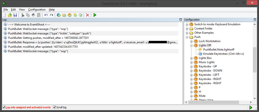

All of these macros used to work before, and were not case sensitive.
Here is a screenshot.
Python is case sensitive.izzy wrote:All of these macros used to work before, and were not case sensitive.
Capital letters are there now in every case (since the new version).
So it should be earlier, but there was a bug, that prevented it.
I'm sorry, but I think it's better now (clearer and especially if it is more than one word).
I think that it not be a lot of work to edit all events.
Remove (at least temporarily) check of checkbox "Log only assigned and activated events".

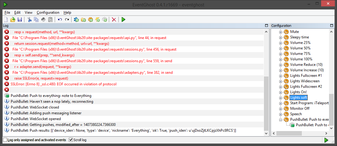

Error on one macro
And no action on the others.
Exception in thread Thread-57681:
File "C:\Program Files (x86)\EventGhost\plugins\PushBullet\__init__.py", line 2008, in push
res, flag = self.request("POST", API + "pushes", data = payload)
File "C:\Program Files (x86)\EventGhost\plugins\PushBullet\__init__.py", line 1778, in request
resp = request(method, url, **kwargs)
File "C:\Program Files (x86)\EventGhost\lib26\site-packages\requests\api.py", line 44, in request
return session.request(method=method, url=url, **kwargs)
File "C:\Program Files (x86)\EventGhost\lib26\site-packages\requests\sessions.py", line 456, in request
resp = self.send(prep, **send_kwargs)
File "C:\Program Files (x86)\EventGhost\lib26\site-packages\requests\sessions.py", line 559, in send
r = adapter.send(request, **kwargs)
File "C:\Program Files (x86)\EventGhost\lib26\site-packages\requests\adapters.py", line 375, in send
raise ConnectionError(e, request=request)
ConnectionError: HTTPSConnectionPool(host='api.pushbullet.com', port=443): Max retries exceeded with url: /v2/pushes (Caused by <class 'socket.error'>: [Errno 10054] An existing connection was forcibly closed by the remote host)
This happens every time you run the macro?izzy wrote:Error on one macro
I need the macro.
It is possible that when this error occurs, you need to restart EventGhost.
Can you describe using more words?izzy wrote:And no action on the others.
I would have understood that in all other macros will not execute any action?
Your posts are too short, you provide little information.
The solution then takes too long. I'm not clairvoyant.
