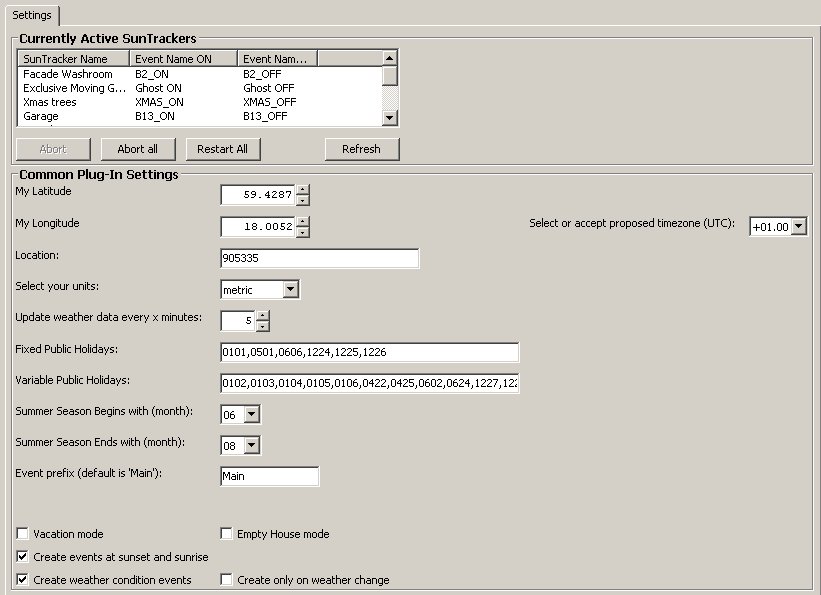

Dear Thahim, sure I will do,
Have you added the SunTracker plugin to your configuration?
If so, first thing you will see is a configuration view. To help you configure it you can tell me,
- what is your location (where do you live, in what country and city), this is needed to get as precise weather information as possible
- your geo references (longitud lattitude), this is needed to calculate correct sunrise and sunset in your location.
This is needed for the starting point of the configuration. There are other settings in the view as well, we will discuss them if unclear but you can also look at my sample below to get a better understanding of those. I hope that you also have found and read the readme file that is included in the SunTracker plugin folder? This will give you a little introduction to the purpose and functionality (some features that have been added later are not covered but we can discuss and explain when needed).
As event prefix, I recommend you to use 'SunTracker' instead of 'Main' as shown in my example below.
Once we are done with this configuration, we will only have the basic plugin up and running. We will then discuss the various actions that are available in the plugin.
My config looks like in the picture below:
