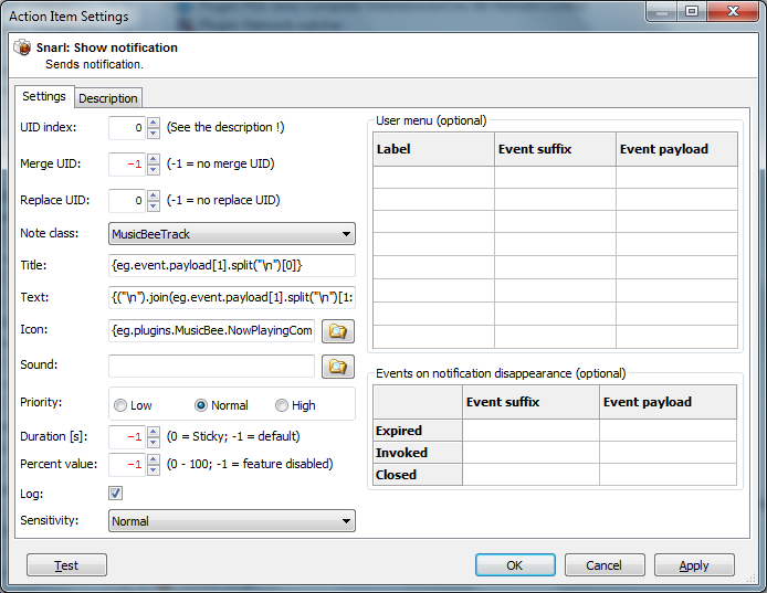

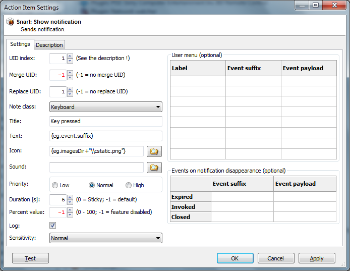

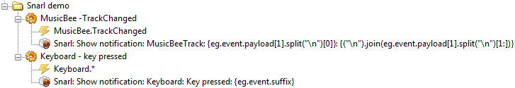

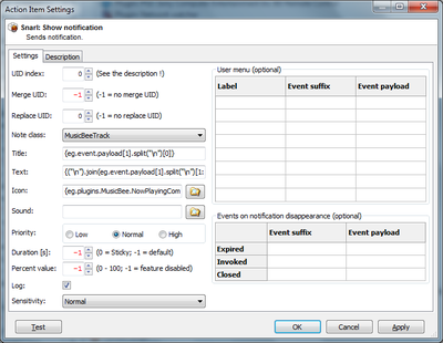

EpicCyndaquil wrote:As an example, I'd like to include the artist and title of the currently playing track in a notification whenever a new track starts playing.
EpicCyndaquil wrote:Or, another example to perhaps make this easier - let's say I want to display a notification each time a "Keyboard" event is logged in EventGhost. I want the Snarl notification to display the key(s) pressed (which EventGhost represents as "Keyboard.<key>", like "Keyboard.A". How could I do this?
On the attached pictures you can see how it can be solved.
Here is the entire macro:
<EventGhost Version="1669">
    <Folder Name="Snarl demo" Expanded="True">
        <Macro Name="MusicBee -TrackChanged" Expanded="True">
            <Event Name="MusicBee.TrackChanged" />
                Snarl.Notify(u'MusicBeeTrack', u'{eg.event.payload[1].split("\\n")[0]}', u'{("\\n").join(eg.event.payload[1].split("\\n")[1:])}', u'{eg.plugins.MusicBee.NowPlayingCommand(82, 128, None, None)}', 1, -1, -1, 0, [], u'', [(u'', u''), (u'', u''), (u'', u'')], -1, 0, True, 0)
        <Macro Name="Keyboard - key pressed" Expanded="True">
            <Event Name="Keyboard.*" />
                Snarl.Notify(u'Keyboard', u'Key pressed', u'{eg.event.suffix}', u'{eg.imagesDir+"\\\\cstatic.png"}', 1, 5, -1, 1, [], u'', [(u'', u''), (u'', u''), (u'', u'')], -1, 1, True, 0)
Note:
In the main dialog Snarl plugin you must create two profiles (Keyboard and MusicBeeTrack).
