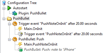

Automatic start at EventGhost startup:
Manual start:
C:\EventGhost\EventGhost.exe -event PushNoteOnInit
